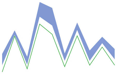

Table 3.2 Area Styles and Descriptions
Area Style
Description
Stacked
Shows areas that correspond to summary statistics for each of the merged variables. The plots are colored, and a legend appears in the Legend zone.
Image shown here
Overlaid
Shows the area plots for the merged variables superimposed over each other. The plots are colored, and a legend appears in the Legend zone.
Image shown here
Range
Shows the area that corresponds to the difference in the summary statistic for the merged variables.
Image shown here
Stacked Range
Shows the areas that correspond to the difference in the summary statistic after the variables are stacked.
Image shown here
