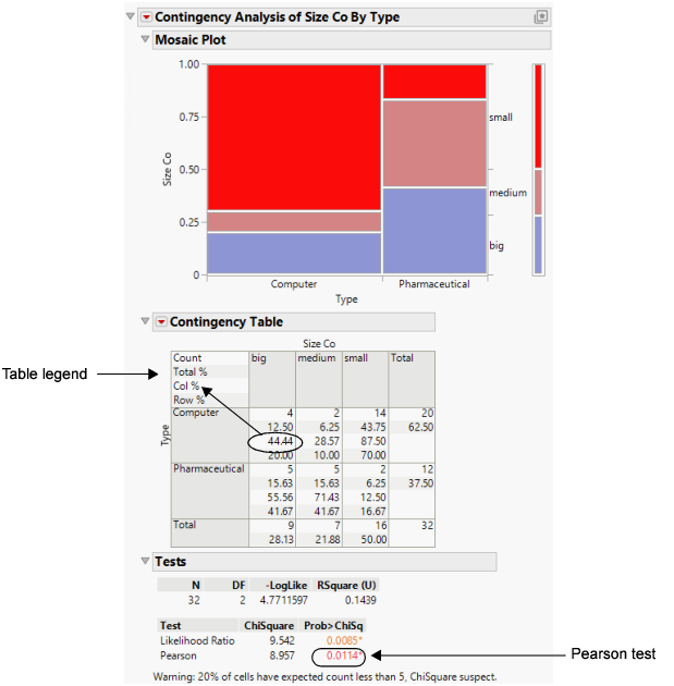

3. Select Analyze > Fit Y by X.
4. Select Size Co and click Y, Response.
5. Select Type and click X, Factor.
6. Click OK.

The Contingency Table contains information that is not applicable for this example. Click the Contingency Table red triangle and deselect Total % and Col % to remove that information. Figure 5.20 shows the updated table.

The statistics in the Contingency Table are graphically represented in the Mosaic Plot. Together, the Mosaic Plot and the Contingency Table compare the percentages of small, medium, and big companies between the two industries. For example, the Mosaic Plot shows that the computer industry has a higher percentage of small companies compared to the pharmaceutical industry. The Contingency Table shows the exact statistics: 70% of computer companies are small, and approximately 17% of pharmaceutical companies are small.

To answer this question, use the p-value from the Pearson test in the Tests report (Figure 5.19). Because the p-value of 0.011 is less than the significance level of 0.05, the financial analyst concludes the following points:
The differences in the sample data are statistically significant.
The percentages differ in the broader population.
