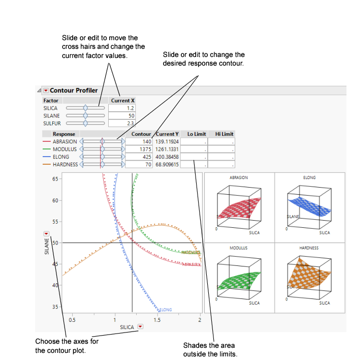

In the Fit Least Squares report, use the interactive Contour Profiler option for optimizing response surfaces graphically. The Contour Profiler shows contours for the fitted model for two factors at a time. The report also includes a surface plot. For more information about the contour profiler, see “Contour Profiler” in Profilers.
Figure 3.34 shows a contour profiler view for the Tiretread.jmp sample data table. Run the data table script RSM for 4 Responses and select Profilers > Contour Profiler from the Least Squares Fit report menu.
Figure 3.34 Contour Profiler
