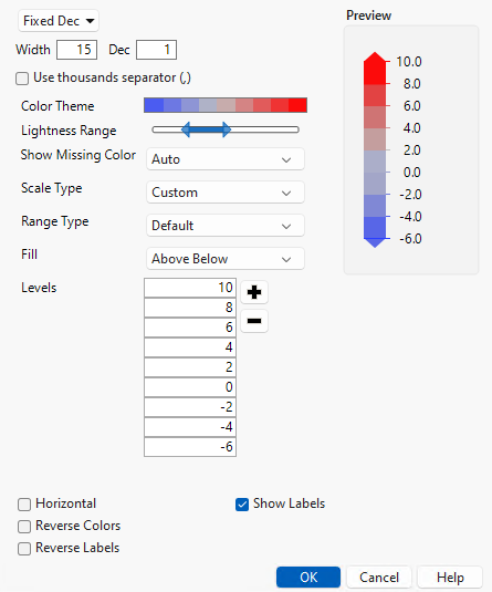

If you do not select options in the Contour Plot launch window, the default plot spaces the contour levels equally within the range of the Y variable. You can specify a color theme by selecting a Continuous Color Theme in File > Preferences > Graphs. You can customize colors for individual contours by right-clicking the contour color in the Contour Plot legend. You can customize the entire contour color gradient by right-clicking the Contour Plot legend and selecting Gradient to open the Gradient Settings. Figure 10.7 shows an example of the Gradient Settings window.
Figure 10.7 Gradient Settings Window
To format the labels in the legend, use the format menu, Width and Dec boxes, and the Use thousands separator (,) check box in the upper left of the window.

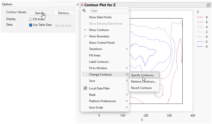

Specify
You can specify contour levels either in the Contour Plot launch window (the Specify button) or in the report window from the Contour Plot red triangle menu (the Specify Contours option). Selecting this option displays the Contour Level Settings.
Figure 10.8 Example of Contour Specification: Launch Window (on the left side) and Menu (on the right side)

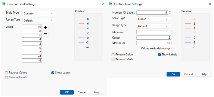

In the Contour Level Settings, you can perform the following actions:
Change the number of contours
Specify minimum and maximum values to define the range of the response to be used in the plot
Change the increment between contour values
Change the scale type to Linear, Quantile, Standard Deviation, Log, Log Offset, or Custom. See Scale Type.
Figure 10.9 Contour Level Settings (Scale Type Custom on the left side, Linear on the right side)
Colors are automatically assigned and are determined by the number of levels in the plot. After the plot appears, you can right-click (press Control and click Apple macOS) on any contour in the plot legend and choose from the JMP color palette to change that contour color.
