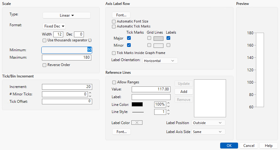

Double-click a numeric axis in a JMP graph to customize it by using the Axis Settings window. Or, right-click the axis area and select Axis Settings to access the window.
Note: You can also customize nominal axes by using the Axis Settings window of the Graph Builder, Distribution, Oneway, and Contingency platforms.
Customization features in the window depend on the data type of the axis and the specific platform that JMP uses to create the plot or chart. Figure 9.40 shows a typical Axis Settings window for numeric (continuous) axes.
Figure 9.40 Axis Settings Window for a Numeric (Continuous) Axis
The Axis Settings window contains the following panels:
Scale
Tick/Bin Increment
Axis Label Row
Reference Lines
The Preview panel shows how your current selections will appear on the axis.

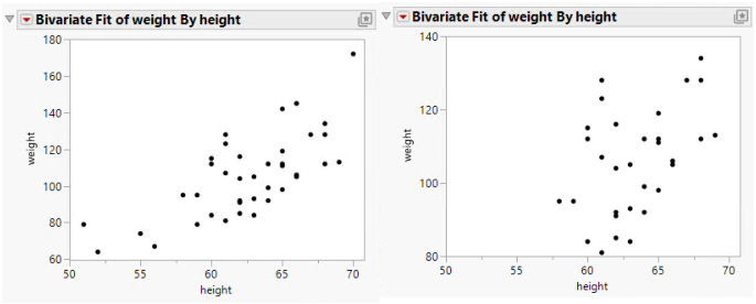

Tip: To set a default minimum and maximum axis value for a variable and avoid making this change every time you run an analysis, see “Axis”.
The example on the right side in Figure 9.41 is an enlargement of the point cluster that shows between 80 and 140 in the plot on the left side of the image. The enlarged plot is obtained by reassigning the maximum and minimum axis values.
Figure 9.41 Rescale Axis to Enlarge a Plot Section

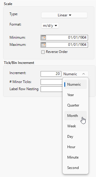

If the axis Format is set to Date, Time, or Duration, a format menu appears beside Increment (Figure 9.42). Select the format for the increments.
Figure 9.42 Selecting the Format for Date and Time Increments

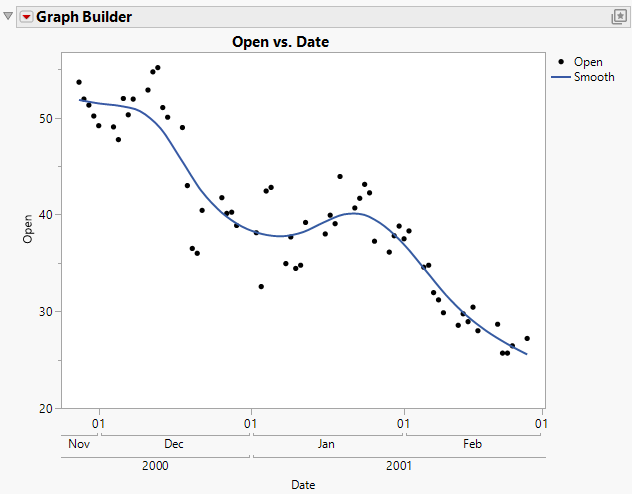

This option appears only if you select Date, Time, or Duration as the axis Format. Label row nesting uses a multilevel time scale to enable you to split a date axis into multiple rows based on the format. For example, you might put the year on the outermost row, then the month, and then the day:
1. Select Help > Sample Data Folder and open Stock Prices.jmp.
3. Drag Date into the X zone.
4. Drag Open into the Y zone.
5. Double-click the X axis.
6. For Format, select Date > ddMonyyyy.
7. Increase the value for Label Row Nesting to 3.
8. Click OK.
9. Click Done to see the finished graph.
Figure 9.43 Example of Label Row Nesting

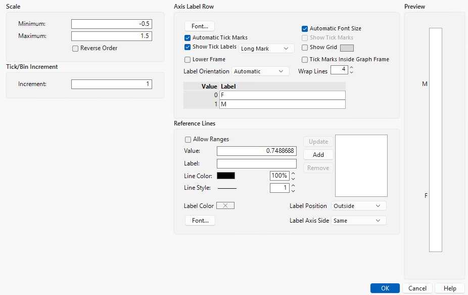

These options can vary depending on whether your axis is continuous or categorical. Figure 9.44 shows axis settings for a categorical axis. Figure 9.40 shows axis settings for a continuous axis.
Figure 9.44 Axis Label Row for a Categorical Axis
Options for continuous axes:
Select Automatic Tick Marks to only turn on tick marks if one or more labels are hidden due to insufficient space.
Add major or minor tick marks, grid lines, or labels by selecting the corresponding check boxes.
Click the Grid Lines color box to change the color of grid lines.
Select Tick Marks Inside Graph Frame to move the tick marks inside the graph.
Options for categorical axes:
The default is to not show tick marks if all of the labels are visible. To add tick marks, select Show Tick Marks. Change the tick mark style by selecting one of the options.
Select Automatic Tick Marks to only turn on tick marks if one or more labels is hidden (due to insufficient space).
Add grid lines by selecting Show Grid.
Click the Show Grid color box to change the color of grid lines.
Select Lower Frame to add a frame around the labels.
Change the number of lines that the text wraps.
Change the labels by entering different values in the Label boxes.

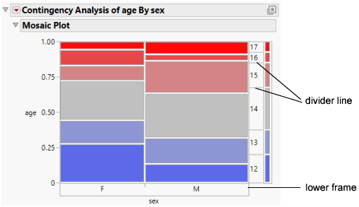

Extend Divider Lines and Frames for Categorical Axes
Extending the vertical divider lines between tick labels is useful when there are many levels of a nominal or ordinal (categorical) variable.
To extend the divider line to the x-axis labels, follow these steps:
1. Double-click a nominal or ordinal axis to show the axis settings.
2. Select Show Tick Labels > Short Divider or Show Tick Labels > Long Divider to add the divider lines.
Use Lower Frame to add a frame around the axis area.
Figure 9.45 Divider Lines
Divider Lines
