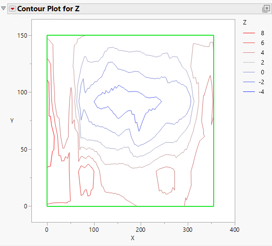

1. Select Help > Sample Data Folder and open Little Pond.jmp.
2. In the Table panel, click the green triangle next to the Contour Plot script.
3. Click the red triangle next to Contour Plot for Z and deselect Fill Areas.
Figure 9.47 Contour Plot before Customization
4. Right-click the plot and select Customize.
The Customize Graph window appears.
5. Click Shape.
6. Change the Line Width to 2.0.
7. Click the color next to Line Color and select a shade of green.
8. Click OK.
Figure 9.48 Customized Contour Plot

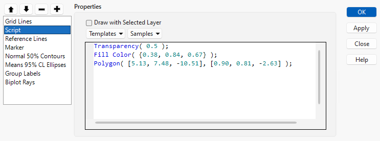

In addition to customizing graphical elements, you can write JSL scripts that add elements. These scripts run when you display the graph. You can write the scripts from scratch, or you can select from the following lists of commands and scripts, which can be accessed by clicking the Add a new script button Image shown here:
Use the Templates list to insert a single JSL command. For example, the Polygon option inserts the Polygon command. The text enclosed in underscores are placeholders for point values, which you replace with your own values.
Polygon([_x0_, _x1_, ... ], [_y0_, _y1_, ...]);
Use the Samples list to insert a script that creates elements such as bubble plots and sine waves. In this list, the Polygon sample script shows examples of the Transparency, Fill Color, and Polygon values, which you replace with your own values.
Figure 9.50 The Polygon Sample Script

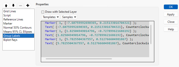

In some graphs, you can view the JSL that creates graphical elements. Figure 9.51 shows the Group Labels script for a Discriminant Analysis graph. The script defines markers and text for group labels. The commands included in these built-in scripts cannot be modified or deleted. You can insert commands from the Templates or Samples list, but you cannot click in the window and enter new commands.
Figure 9.51 Example of JSL That Creates Group Labels
For information about JSL, see the Scripting Guide and the JSL Syntax Reference.
To create a graphics script, follow these steps:
1. Right-click the graph and select Customize.
2. Click the Add a new script button Image shown here to create a new script.
The default name, Script, is highlighted.
3. With the default name highlighted, enter a more descriptive name and press Enter.
(If you already moved the cursor and the name is no longer highlighted, double-click Script and enter the new name.)
4. Do one or more of the following tasks:
Enter JSL in the Properties window.
Select one or more JSL commands from the Templates list, and change the placeholder text. For example, change the Pen Color option from “blue” to “red.”
Select one or more sample scripts from the Samples list and update, if necessary.
5. (Optional) Click Apply to update the graph with your changes without closing the window.
Unlike other property changes, script changes do not take effect until you click Apply or OK.
6. Click OK to save your changes.
One of the following results occurs:
The element that you created appears on the graph.
An error message appears if the script contains an error. Select View > Log to read about the error and then correct the script.
To delete a script that you created, select the script and then select the Delete selected object button Image shown here.
