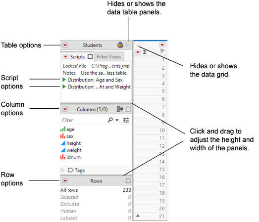

In JMP data tables, the Table, Columns, and Rows panels contain information about the data table and its contents. These interactive panels are located on the left side of the data grid.
Figure 2.4 Interacting with the Data Table Panels
Table Panel in Data Tables
The Table panel contains the following elements:
Data table name
The Scripts panel
The Filter Views panel
Icons that indicate the table state
Red triangle menus that contain table options
Figure 2.5 Example of a Table Panel
Table Options

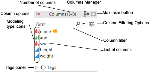

Columns Panel in Data Tables
The Columns panel provides a way to view and move columns. The panel contains the following information:
Column options. This option contains some of the same options as the Cols menu.
Total number of columns and number of columns selected in the data table.
The Columns Manager button Image shown here. See “About the Columns Manager”.
A maximize button Image shown here for the Columns panel.
A filter box to help you quickly find columns. Click the magnifying glass icon to set search filter options and parameters.
The More Column Filtering Options button Image shown here. See “Column Filtering Options”.
A list of columns found in the data table.
Icons that indicate each column’s modeling type. See “About Modeling Types”.
Icons that represent characteristics and properties that are assigned to the columns (not shown, see Figure 2.7).
The Tags panel.
Figure 2.6 Example of a Columns Panel

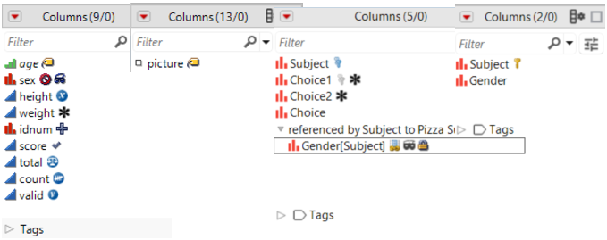

Icons That Represent Column Characteristics and Properties
Icons to the right side of each column name indicate characteristics and properties that the columns contain.
Figure 2.7 Icons That Indicate Column Characteristics and Properties
Note: Italics indicate that the column is locked into place. When you scroll horizontally, the column remains visible.
Here are the icons that can appear in the Columns panel:
Image shown here Indicates that points on plots that correspond to the column are labeled by the value instead of by the row number. See “Label Rows and Columns”.
Image shown here Indicates that the column is excluded from the calculations. See “Exclude Rows in Data Tables”.
Image shown here Indicates that the column is not included in graphs. See “Hide Rows in Data Tables”.
Image shown here Can be X or Y. Indicates that the column has been assigned the preselected role of x or y. See “Assign a Preselected Analysis Role to a Column”.
Image shown here Indicates that the column has been assigned the preselected role of validation. See “Assign a Preselected Analysis Role to a Column”.
Image shown here Indicates that the column contains one or more properties. Click to reveal a list of properties that the column contains.
Image shown here Indicates that the values in the column are the result of a formula. When formula evaluation is suppressed, the icon appears gray. Double-click to view and edit the formula. See “JMP Formula Editor Options”.
Image shown here Indicates that the range check or the list check option is turned on. Click to view and edit the range or list. See “Range Check” and “List Check”.
Image shown here Indicates that the column has been assigned the preselected role of weight. See “Assign a Preselected Analysis Role to a Column”.
Image shown here Indicates that the column has been assigned the preselected role of frequency. See “Assign a Preselected Analysis Role to a Column”.
Image shown here Indicates that the column values cannot be edited. See “About the Column Info Window”.
Image shown here Indicates that the expression column contains images that can be used as markers. See “Use Images as Markers”.
Virtual Join Icons
Image shown here Indicates that the column has a Link Reference column property. This property links a column in the current data table to the ID column in the referenced data table. Blue indicates that the referenced data table is linked.
Image shown here Indicates that the column has a Link Reference column property. Gray indicates that the referenced data table is not open or not linked properly.
Image shown here Indicates that the column has a Link ID column property, which marks a column in the data table as the ID column. That is, the rows of the data table are uniquely identified by the values of the ID column.
Image shown here Indicates that the column is linked from the referenced data table.
For more information about virtual join, see “Virtually Join Data Tables”.

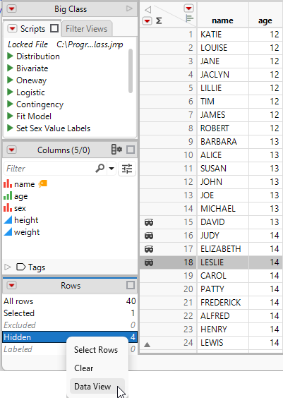

Rows Panel in Data Tables
The Rows panel contains the following information:
Row options (same options as the Rows menu)
Total number of rows
Number of selected (highlighted), excluded, hidden, and labeled rows
Figure 2.8 Example of a Rows Panel
Right-click the categories in the Rows panel to select rows, clear the selection, or to create a data view.
A data view creates a linked subset of the main data table. For example, if several rows are marked as hidden, you might want to open a window that shows you only the hidden rows. Right-click Hidden in the Rows panel and select Data View.
Figure 2.9 Creating a Data View from the Rows Panel
When using a data view, continue to do most of your editing in the main data table. When you make changes in either the main data table or in the data view, the changes are reflected in both. You can make minor changes (such as changing some data or adding a column) in the data view. However, if you want to make major changes (such as adding a formula), you must make those changes in the main data table.
