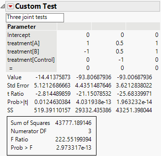

8. Fill in the editable area with a test name and enter values in the three columns as shown in Figure 4.48.
To see how to obtain these values, particularly those in the third column, see “Interpretation of Parameters”.
Figure 4.48 Custom Test Specification Report for Three Contrasts
9. Click Done.
Figure 4.49 Custom Test Report That Shows Tests for Three Contrasts
The results indicate that all three hypotheses are individually, as well as jointly, significant.
