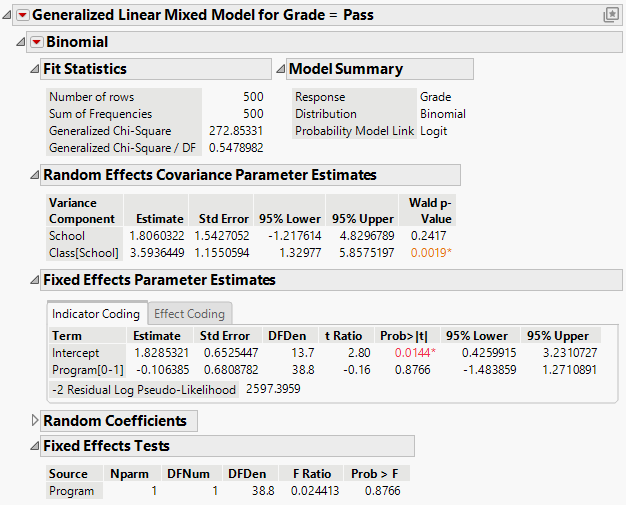

This example illustrates using the Generalized Linear Mixed Model personality of the Fit Model platform to evaluate two teaching programs. In an educational study, classes of students from multiple schools were assigned to one of two programs. At the end of the program, students took an evaluation test for which they receive a grade of Pass or Fail.

9. Click Run.
The Generalized Linear Mixed Model report is shown in Figure 9.4. The effect of the teaching program is not statistically significant. However, the class effect nested within school is statistically significant.

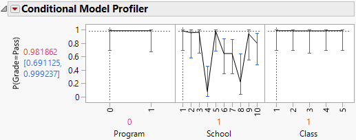

10. Click the red triangle next to Binomial and select Conditional Model Inference > Conditional Profiler.
You can use the Conditional Model Profiler to explore the differences in pass rates for various classes and schools.
