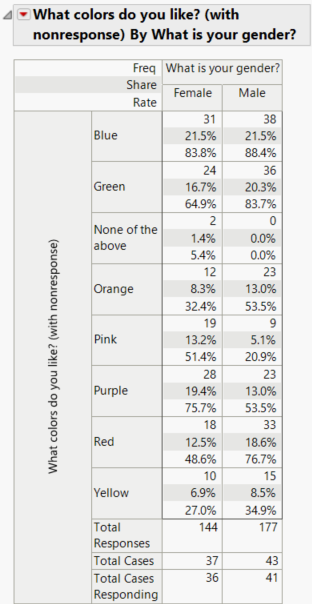

Figure 3.45 Initial Crosstabulation
Note that the number of total cases is higher than the number of total cases responding. There are 37 Females who filled out the survey but only 36 responded to this question.

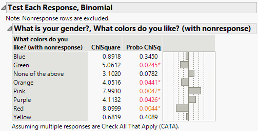

8. Click the Categorical red triangle and select Test Multiple Responses > Exclude Nonresponses.
9. Click the Categorical red triangle and select Test Multiple Responses > Homogeneity Test, Binomial.
Figure 3.46 Binomial Homogeneity Test Results
The analysis supports that blue and yellow have similar preference levels across genders while other colors tend to be favored more or less across genders. For example, Red appears to be liked more by males than by females. The p-value for the test is 0.0044, which supports a conclusion that there is a difference in preference across genders. From the crosstab in Figure 3.45 you find that 76.7% of the males liked the color red as compared to 48.6% of the females.
The note at the top of the output indicates that nonresponse rows are excluded from the analysis. The note at the bottom of the output indicates that it is assumed that the multiple response is a check all that applies type question. This means that a respondent can select more than one response to the question. The tests are performed using only those rows with responses. The three rows that did not have responses for the question are not included.
