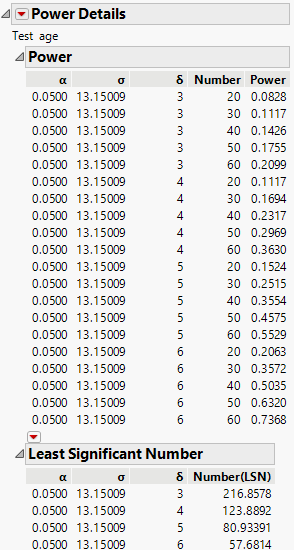

10. Click Done.
The Power Details window is replaced by the Power Details report.
Figure 4.58 Power Details Report for Age
This analysis is a retrospective power analysis because the calculations are based on the data already collected. For example, the calculation of power in this example depends on the effects entered into the model and the number of participants in each age and sex grouping. Also, the value of σ was derived from the current study, though you could have replaced it with a value that would be representative of a future study.
