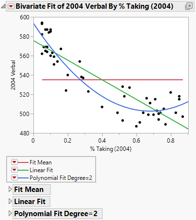

In the Bivariate platform, use the Fit Line, Fit Polynomial, or Fit Special options to fit regression models. You can fit multiple models and then compare the fits on the scatterplot.
Figure 5.8 Example of Fit Line and Fit Polynomial
For more information about the options in the Linear Fit and Polynomial Fit Degree menus, see Bivariate Fit Options. For statistical details, see Statistical Details for the Fit Line Option.

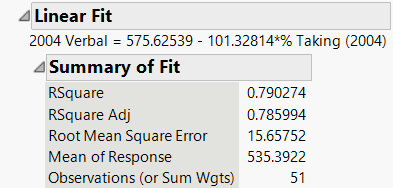

Summary of Fit
In the Bivariate platform fit reports, the Summary of Fit table contains numerical summaries of the model fit. The equation for the fit is shown above the Summary of Fit table.
Figure 5.9 Summary of Fit Table
The Summary of Fit table contains the following statistics:
RSquare
The proportion of the variation explained by the model. The remaining variation is attributed to random error. The RSquare is 1 if the model fits perfectly. See Statistical Details for the Summary of Fit Report.
Note: A low RSquare value suggests that there might be variables not in the model that account for the unexplained variation. However, if your data are subject to a large amount of inherent variation, even a useful regression model can have a low RSquare value. Read the literature in your research area to learn about typical RSquare values.
RSquare Adj
The RSquare statistic adjusted for the number of parameters in the model. The adjusted R2 statistic enables you to make comparisons among models that contain different numbers of parameters. See Statistical Details for the Summary of Fit Report.
Root Mean Square Error
The estimate of the standard deviation of the random error. This quantity is the square root of the mean square for Error in the Analysis of Variance report (Figure 5.11).
Mean of Response
The sample mean (arithmetic average) of the response variable. This is the predicted response when no model effects are specified.
Observations (or Sum Wgts)
The number of observations used to estimate the fit. If there is a weight variable, this is the sum of the weights.
