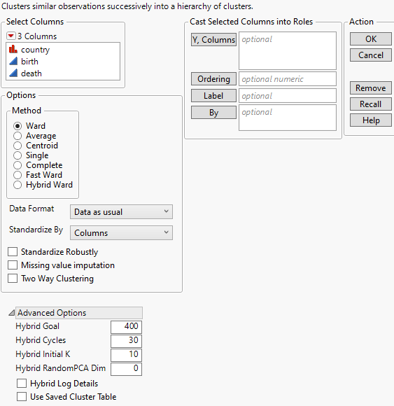

Launch the Hierarchical Cluster platform by selecting Analyze > Clustering > Hierarchical Cluster.
Figure 13.4 Hierarchical Cluster Launch Window
