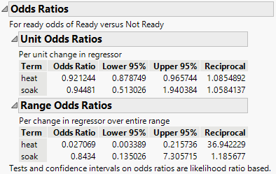

Odds Ratios
(Not available for nominal responses with more than two levels.) Shows or hides an Odds Ratios report that contains Unit Odds Ratios and Range Odds Ratios. See Statistical Details for Odds Ratios.
Figure 12.6 Odds Ratios
Odds Ratios
