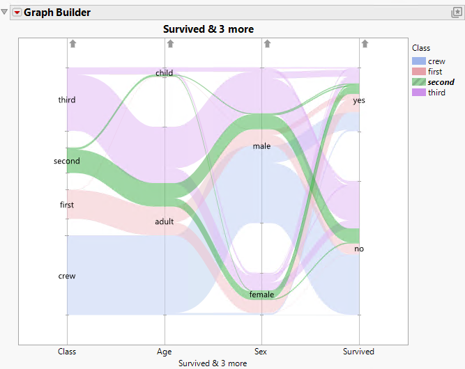

When all variables are categorical, there is a band for every combination of levels of the categorical variables. The bands split as they move from left to right. In the first interval that corresponds to a categorical variable, there is a band for every level of that categorical variable. In the last interval that corresponds to categorical variables, there is a band for every possible combination of the categorical variables.
Figure 3.43 Example of Categorical Bands by Using Titanic.jmp
In Figure 3.43, the band that contains all second-class passengers is selected. The parallel plot shows that most were adults, there were more males than females, and slightly fewer survived than did not survive.

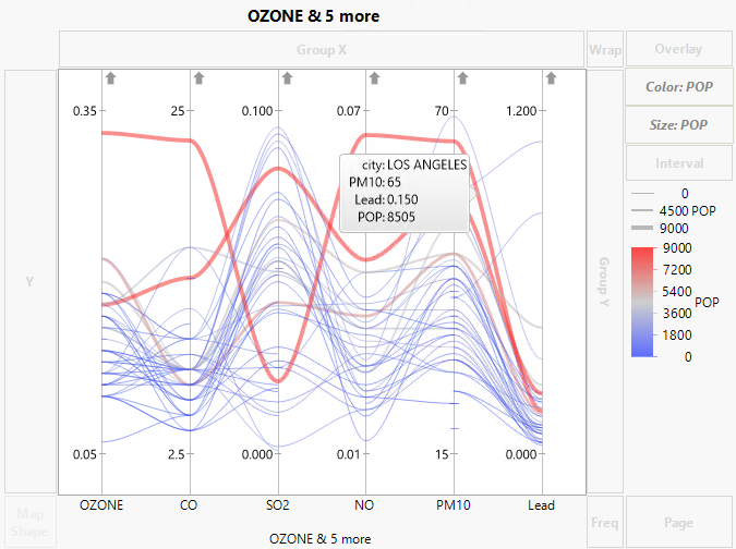

Figure 3.44 shows a parallel plot for six variables in the Cities.jmp data table. The variable POP is used both as a Color and Size variable. The curve for Los Angeles is labeled.
Figure 3.44 Parallel Plot for Pollution Data in Cities.jmp

By default, the scales for the values of the variables are adjusted so that the minimum and maximum values are plotted at the same level. For example, in Figure 3.44, the values of each of the variables have an identical vertical spread. Each vertical line is labeled by the minimum and maximum values of the variables.
In Figure 3.44, the scales for CO and PM10 differ greatly from the scales of the other variables. When your variables are measured on very different scales, this scaling enables you to see differences clearly.
