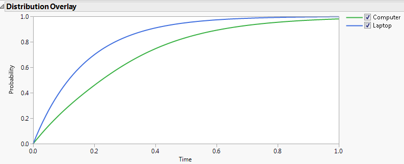

Image shown hereShow Design Comparisons
The Show Design Comparisons option displays a Distribution Overlay plot and a Remaining Life Distribution Overlay plot. These plots appear in the Workspace below the System Diagram. See Figure 13.12 and Figure 13.13.
The Distribution Overlay plot shows the probability of system failure for each of the designs in the Designs panel.

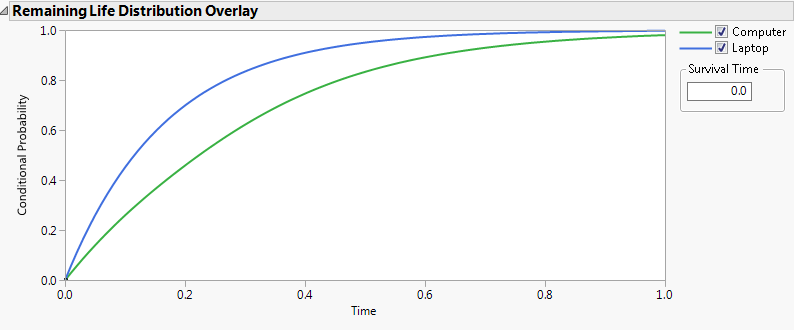

The Remaining Life Distribution Overlay plot shows the conditional probability of failure for each design in the Designs panel, given that the systems have survived to a specified survival time. Enter the Survival Time in the box to the right of the plot. Alternatively, select the small rectangle at the origin and drag it to the right to dynamically set the Survival Time.
Check boxes enable you to select which designs are represented in the plots. This enables you to compare a subset of designs with respect to failure probabilities.
Tip: To hide the system diagram in the Workspace, click the Reliability Block Diagram red triangle and deselect Show Design Diagram. Alternatively, to show more of the Design Comparisons, reposition the horizontal splitter upward.
Figure 13.12 Distribution Overlay Example
Figure 13.13 Remaining Life Distribution Overlay Example
