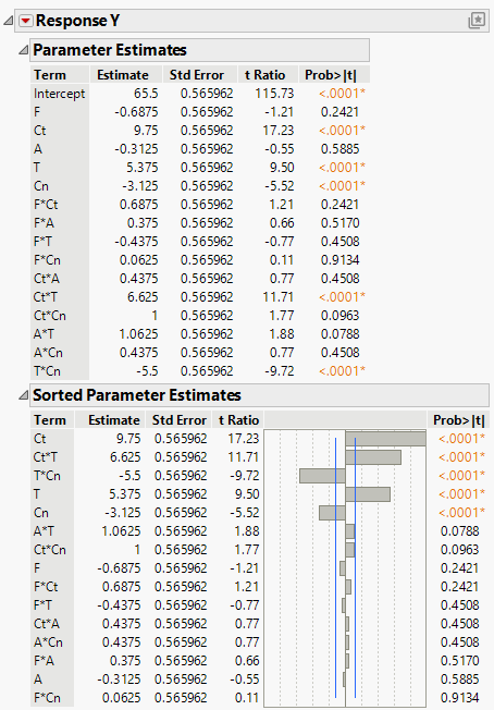

In the Fit Least Squares report, the Sorted Estimates option produces a version of the Parameter Estimates report that is useful in screening situations. If the design is not saturated, the Sorted Estimates report gives the information found in the Parameter Estimates report, but with the terms, other than the Intercept, sorted in decreasing order of significance (second report in Figure 3.19). If the design is saturated, then Pseudo t tests are provided. These are based on Lenth’s pseudo standard error (Lenth 1989). See Lenth’s PSE.
Figure 3.19 Sorted Parameter Estimates
The Sorted Parameter Estimates report also appears automatically if the Emphasis is set to Effect Screening and all of the effects have only one parameter.
Note the following differences between the Parameter Estimates report and the Sorted Parameter Estimates report (both shown in Figure 3.19):
The Sorted Parameter Estimates report does not show the intercept.
The effects are sorted by the absolute value of the t ratio, showing the most significant effects at the top.
A bar chart shows the t ratio with vertical lines showing critical values for the 0.05 significance level.

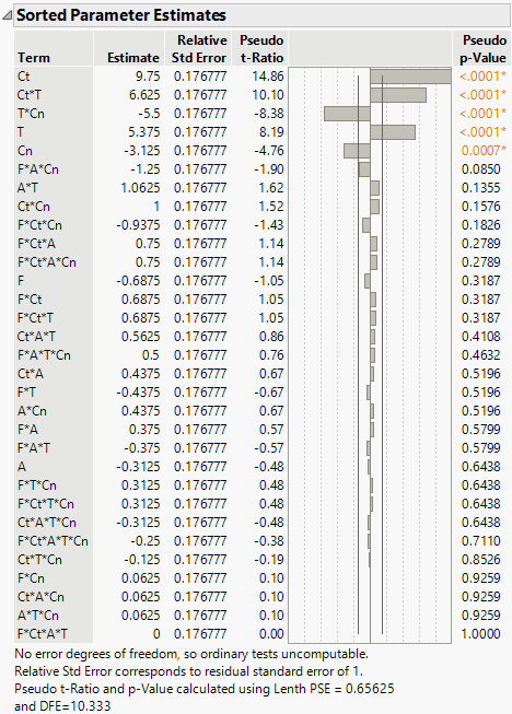

Sorted Estimates Report for Saturated Models
Screening experiments often involve fully saturated models, where there are not enough degrees of freedom to estimate error. In these cases, the Sorted Estimates report (Figure 3.19) gives relative standard errors and constructs t ratios and p-values using Lenth’s pseudo standard error (PSE). These quantities are labeled with Pseudo in their names. See Lenth’s PSE and Pseudo t-Ratios. A note explains the change and shows the PSE.
The report contains the following columns:
Term
The model term whose coefficient is of interest.
Estimate
The parameter estimates are presented in sorted order, where the smallest p-values listed first.
Relative Standard Error
If there are no degrees of freedom for residual error, the report gives relative standard errors. The relative standard error is computed by setting the root mean square error equal to 1.
Pseudo t-Ratio
A t ratio for the estimate, computed using pseudo standard error. The value of Lenth PSE is shown in a note at the bottom of the report.
Pseudo p-Value
A p-value computed using an error degrees of freedom value (DFE) of m/3, where m is the number of parameters other than the intercept. The value of DFE is shown in a note at the bottom of the report.

Figure 3.20 Sorted Parameter Estimates Report for Saturated Model
Note that Lenth’s PSE and the degrees of freedom used are given at the bottom of the report. The report in Figure 3.20 indicates that, based on their Pseudo p-Values, the effects Ct, Ct*T, T*Cn, T, and Cn are highly significant.
