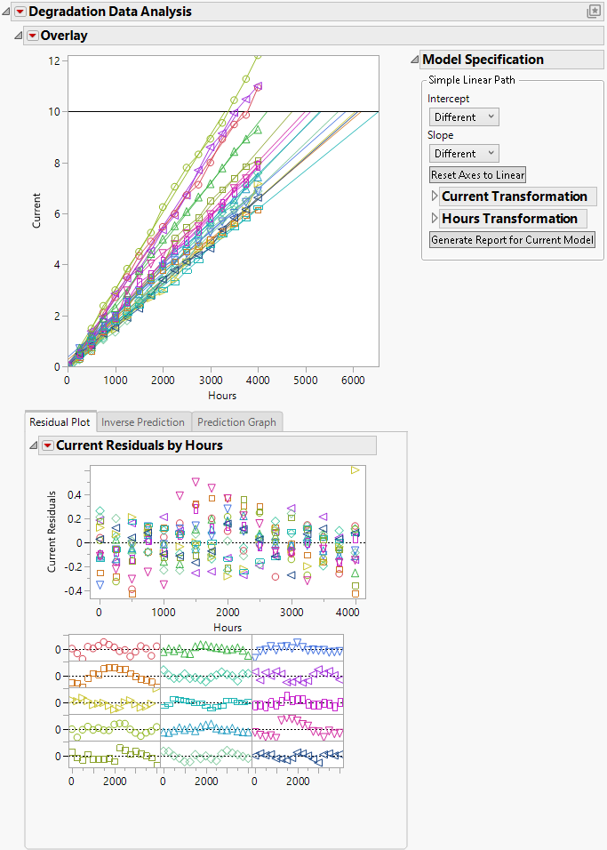

The Degradation Data Analysis report depends on the method selected in the launch window. The Repeated Measures Degradation and Destructive Degradation methods show a report that fits a default model. As shown in the Model Specification report in Figure 16.4, this model fits each unit with its own intercept and slope, using a linear transformation of the response and time columns. Separate intercepts and slopes are fit for each value of the Label, System ID variable, or, if only an X variable is specified, separate intercepts and slopes are fit for each level of the X variable. The Stability Test method fits three models.
Figure 16.4 Initial Repeated Measures Degradation ReportĀ
To reproduce this example, see Example of the Degradation Platform.

Overlay
An Overlay plot of the Y, Response variable versus the Time variable. In this example, the plot is of Current versus Hours. The Save Estimates option in the Overlay plot red triangle menu creates a new data table containing the estimated slopes and intercepts for all units.
Model Specification
Specify your model and generate a report for that model. See Model Specification. (Available only for the Repeated Measures Degradation and Destructive Degradation methods.)

Residual Plot
Shows a single residual plot with all the units overlaid and separate residual plots for each unit arranged in a rectangular grid. The red triangle menu contains the following options:
Save Residuals
Saves the residuals for the current model to a new data table.
Jittering
Adds random noise to the points in the time direction. This is useful for visualizing the data if there are a lot of points clustered together.
Separate Groups
Adds space between the groups to visually separate the groups. This option appears only when an X variable is specified on the platform launch window.
Jittering Scale
Changes the magnitude of the jittering and group separation. This option appears only if Jittering is selected.
