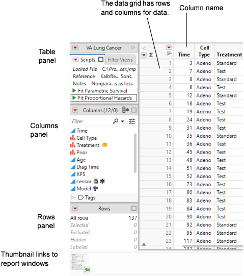

Select Help > Sample Data Folder and double-click the VA Lung Cancer.jmp sample data table to open it and see the data table described here.
Figure 2.4 A Data Table
A Data Table
A data table contains the following parts:
Data grid
The data grid contains the data arranged in rows and columns. Generally, each row in the data grid is an observation, and the columns (also called variables) give information about the observations. In Figure 2.4, each row corresponds to a test subject, and there are 12 columns of information. Although all 12 columns cannot be shown in the data grid, the Columns panel lists them all. The information given about each test subject includes the time, cell type, treatment, and more. Each column has a header, or name. That name is not part of the table’s total count of rows.
Table panel
The table panel can contain table variables or table scripts. In Figure 2.4, there is one saved script called Model that can automatically re-create an analysis. This table also has a variable named Notes that contains information about the data. Table variables and table scripts are discussed in a later chapter.
Columns panel
The columns panel shows the total number of columns, whether any columns are selected, and a list of all the columns by name. The numbers in parentheses (12/0) show that there are 12 columns and that no columns are selected. An icon to the left side of each column name shows that column’s modeling type. Modeling types are described in “Understand Modeling Types”. Icons to the right side of the column name show attributes that are assigned to the column. For more information about these icons, see “View or Change Column Information in a Data Table”.
Rows panel
The rows panel shows the number of rows in the data table and how many rows are selected, excluded, hidden, or labeled. In Figure 2.4, there are 137 rows in the data table.
Thumbnail links to report windows
This area shows thumbnails of all reports that are based on the data table. Hover over a thumbnail to see a larger preview of the report window. Double-click a thumbnail to bring the report window to the front.
