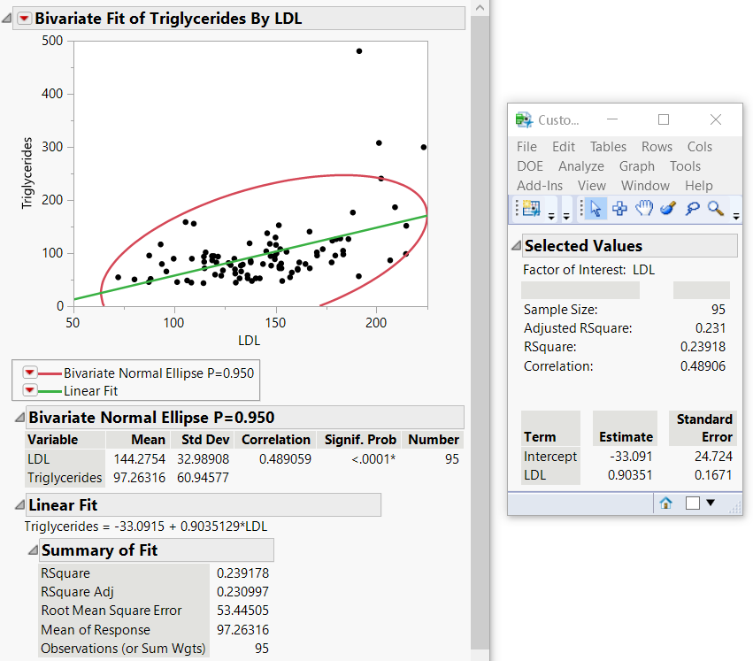

Using JSL, you can capture specific results of an analysis into a custom report.The JMP platforms in the Analyze and Graph menus contain two objects known as the analysis and report layers. Messages are sent to the analysis layer that generate the desired results.
Extract Values from Reports.jsl performs a Bivariate analysis and shows results such as the sample size, RSquare, and Correlation in a new report window. Figure 18.4 shows the Bivariate report along with the customized report, though the Bivariate report window closes after the script is finished.

Figure 18.4 Customized Report from the Bivariate Analysis
