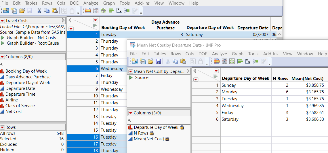

Select Where Using Dates.jsl applies the Date MDY format to a column of departure dates and subsets the data. A summary table of mean net costs by departure date then appears (Figure 18.2).

Figure 18.2 The Original Table and the Final Summary Table
