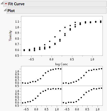

The Fit Curve Report appears. The Plot report contains an overlaid plot of the fitted model of each formulation.
Figure 13.2 Initial Fit Curve Report

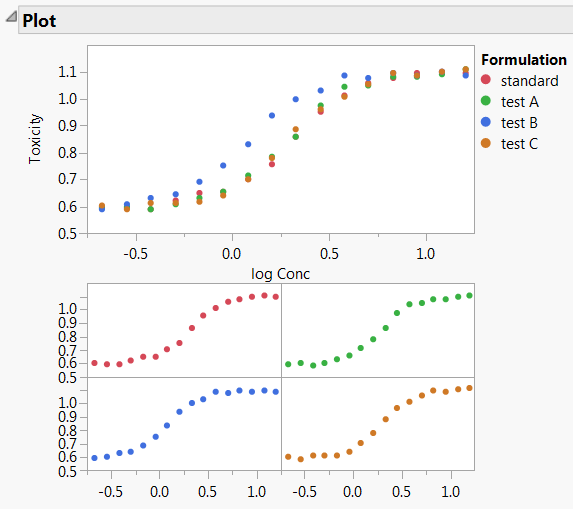

7. To see a legend identifying each drug formulation, right-click one of the graphs and select Row Legend. Select Formulation for the column and click OK.
Figure 13.3 Fit Curve Report with Plot Legend
The curves appear S-shaped, so a sigmoid curve would be an appropriate fit. Table 13.1 shows formulas and graphical depictions of the different types of models that the Fit Curve platform offers.

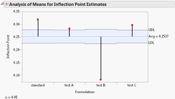

9. Click the Logistic 4P red triangle and select Compare Parameter Estimates.
Figure 13.5 Parameter Comparison Report
Notice that the Inflection Point parameter for the test B formulation is significantly lower than the average inflection point. This agrees with the plots shown in Figure 13.4. Drug formulation B has a higher toxicity ratio than the other formulations.
