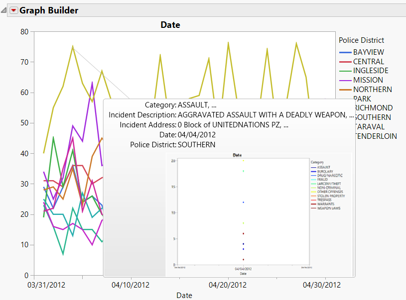

Suppose that you are looking at crime over time in the San Francisco Crime.jmp sample data table. You use a line chart where X = Date, an overlay of Police District, and no Y assignment. Lines represent counts over time per district. Now you want to use a graphlet to look at crime over time inside each district, broken down by category. Create this new graph and select Save > to Clipboard and then Paste Graphlet on the original graph to create the graphlet. However, the hovered graph shown in Figure 12.42 is not what you expect.
Figure 12.42 Initial Filtered Data
此处显示图片

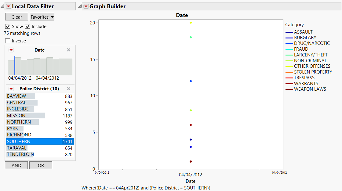

JMP created a filter based on both roles, X and the overlay. This is easier to see if you click on the graphlet to launch the new graph, and then expand the local data filter (on the left, collapsed by default). The filter on a single day causes the line chart to collapse into what looks like a marker plot as shown in Figure 12.43.
Figure 12.43 Local Data Filter with a Line Chart that Looks like a Marker Plot
此处显示图片

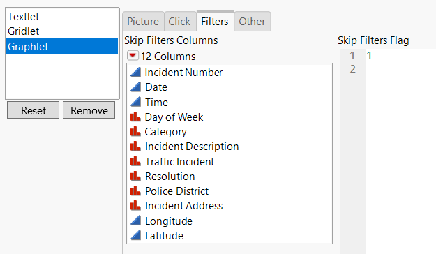

You want the overlay value to restrict what you see in the new graph. However, you don’t want the date value to do so. You still want to filter by the “SOUTHERN” Police District, but you do not want to filter on “04/14/2012” Date.
The solution is to use the Skip Filters Flag to remove the filter on Date from your original graph. On the Hover Label Editor, the script looks like this:
Figure 12.44 Example of Skip Filters Flag script in the Hover Label Editor
此处显示图片
