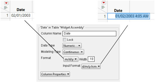

Suppose that you are entering dates into a column using the d/m/y h:m format, but you want to see the dates in the m/d/y format. Input Format defines the input format, and Format defines the display format. For example,
New Table( "Widget Assembly",
	Add Rows( 1 ),
	New Column( "Date",
		Numeric,
		"Continuous",
		Format( "m/d/y" ),
		Input Format( "d/m/y h:m" ),
		Set Values( [3126917100] )
The Format and Input Format values are shown in the data table’s column properties (Figure 6.3). Note that when you click in the cell to edit it, the date-time value appears in the input format. When you edit the value, or add a new value, the format specified in the data table column Format list is used to display the value.
