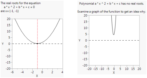

When you run the preceding script, you first see a window like this:
Figure 11.32 A Custom Platform Launch Window
此处显示图片
Clicking OK, displays a results window (Figure 11.33, left), with either the roots or an error message. Rerun the script, input 5, 4, and 5 respectively and click OK. Note that JMP displays an error message (Figure 11.33, right).
Figure 11.33 The Custom Platform’s Report
此处显示图片
