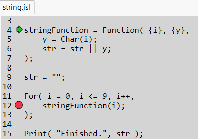

2. Click in the margin for line 12 to add a breakpoint.
You should have a breakpoint for the following expression inside the For() loop:
stringFunction(i);
Figure 4.12 Set the Breakpoint

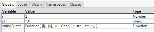

The script runs until it hits the breakpoint. The results are shown in Figure 4.14.
– stringFunction() is called, evaluated, and returns to the loop.
– i is incremented and determined to be less than or equal to 9.
– In the Globals list, i is now 1 and str is now “0”.

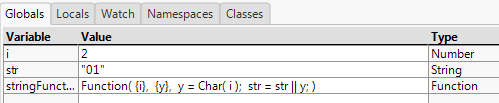

5. Click Run again.
The script runs until it hits a breakpoint. The results are shown in Figure 4.15.
In the Globals list, i is now 2, and str is now “01”.
Figure 4.15 Global Variables at Second Breakpoint
此处显示图片

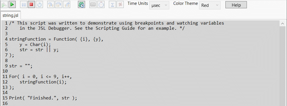

2. Click the Debug Script button 此处显示图片.
3. Click the Profile JSL Script button 此处显示图片.
Figure 4.16 Initial JSL Profiler Window
此处显示图片

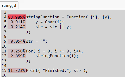

4. Click the Run button 此处显示图片 to start profiling.
The profiler collects information about the number of times a statement is executed and the time it takes to execute it. Time is cumulative and collected each time a JSL statement is executed.
Figure 4.17 Profiled Script Window
此处显示图片
In the left margin, the selected statistics are displayed. Percent of time is displayed by default. Click the Show Profile by Count button 此处显示图片 to switch to percent of statement counts instead. The left margin is color-coded to allow for quick identification of problematic performance areas.
