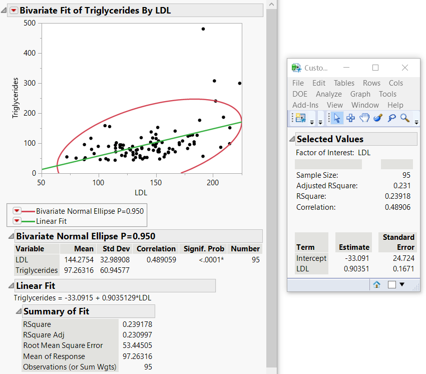

Extract Values from Reports.jsl performs a Bivariate analysis and shows results such as the sample size, RSquare, and Correlation in a new report window. Figure 18.4 shows the Bivariate report along with the customized report, though the Bivariate report window closes after the script is finished.

Figure 18.4 Customized Report from the Bivariate Analysis
