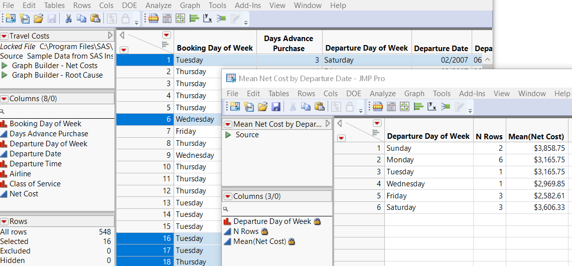

Select Where Using Dates.jsl applies the Date MDY format to a column of departure dates and subsets the data. A summary table of mean net costs by departure date then appears (Figure 18.2).

/* Create a summary table, grouping mean cost by day of week that departure
took place. */
sumDt = nt2 << Summary(
	Group( :Departure Day of Week ),
	Mean( :Net Cost ),
	Output Table Name( "Mean Net Cost by Departure Date" )
Figure 18.2 The Original Table and the Final Summary Table
