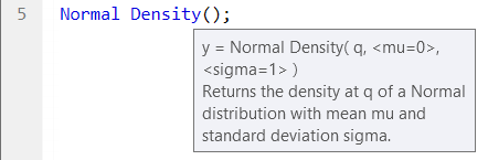

If you are using a JSL function and do not remember the syntax or need more information about it, place the cursor over it to see a brief explanation. This works only with JSL function names, not platform commands, messages, or user-created functions. JSL function names are colored blue in the script editor.
The tooltip shows the syntax, arguments, and a brief explanation of the function (Figure 4.4). The tip also appears in the script editor window status bar.
Figure 4.4 Tooltip for a JSL Function
此处显示图片
After running a script, you can also place the cursor over variable names to see their current value. To turn off variable tooltips, deselect Preferences > Script Editor > Show Variable Value Tips.
To turn off function tooltips, deselect Preferences > Script Editor > Show Operator Tips.
