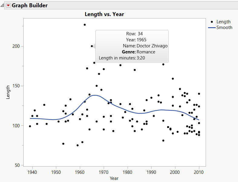

Figure 12.46 shows adding Genre, Name, and Length in minutes, reformatting the minutes, and formatting “Genre” in bold.
Figure 12.46 Customized Gridlet
此处显示图片
Example of Customizing a Gridlet
The following script creates the graph and hover label shown in Figure 12.46.

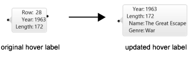

Figure 12.47 shows the original hover label and the updated hover label. Notice that Row was removed from the label. Name and Genre were added.
Figure 12.47 Example of the Expunge and Annex Commands
此处显示图片
The following script creates the updated hover label shown in Figure 12.47.
