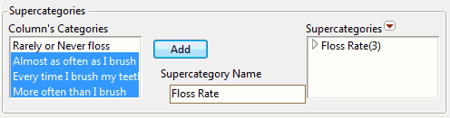

Select Column Properties > Supercategories.
The column properties window shows the Supercategories options (Example Supercategories Configuration).
Click Add to create the supercategory.
From the Supercategories red triangle menu, select from the following options:
Options > Hide: Hides data in the selected supercategory from reports and graphs.
Add All: Creates a supercategory from all of the categories in the column.
Add Mean and Add Std Dev: Calculate statistics for value scores. See the Consumer Research book for more information.
Click OK to add the property to the column.

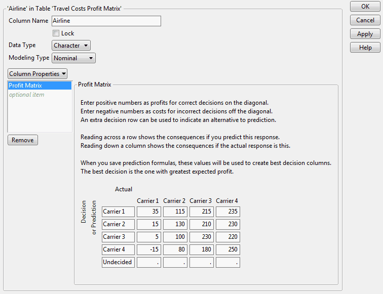

Use the Profit Matrix property to enhance a predictive model by converting it to a decision model and assigning weights to outcomes. To access the feature, select Column Properties > Profit Matrix. A matrix table appears, using each value in the selected column.
After completing the profit matrix, save the prediction formulas for use in creating best decision columns. The best decision is the one with the greatest expected profit. The example below (Example of Profit Matrix Window) uses the Airline column in the Travel Costs.jmp sample data table.
In a sample scenario, a travel agency uses four airlines to service its customers. The airlines range from Carrier 1, a low budget airline, up to Carrier 4, a luxury airline. The agency earns money by selling airline tickets to its customers. Depending on the carrier selected by the customer, the agency expects a certain amount of profit for each ticket sold. When the agency recommends a carrier, they reserve a ticket for a small fee (this is the prediction). If the customer decides to take the recommended carrier the agency profits by a certain amount less the reservation fee. However, if the customer decides to take a different carrier, the agency loses the reservation fee already paid and must purchase the alternate ticket and pay another reservation fee. As a result, the agency’s profit margin is less than predicted.
Click OK.
