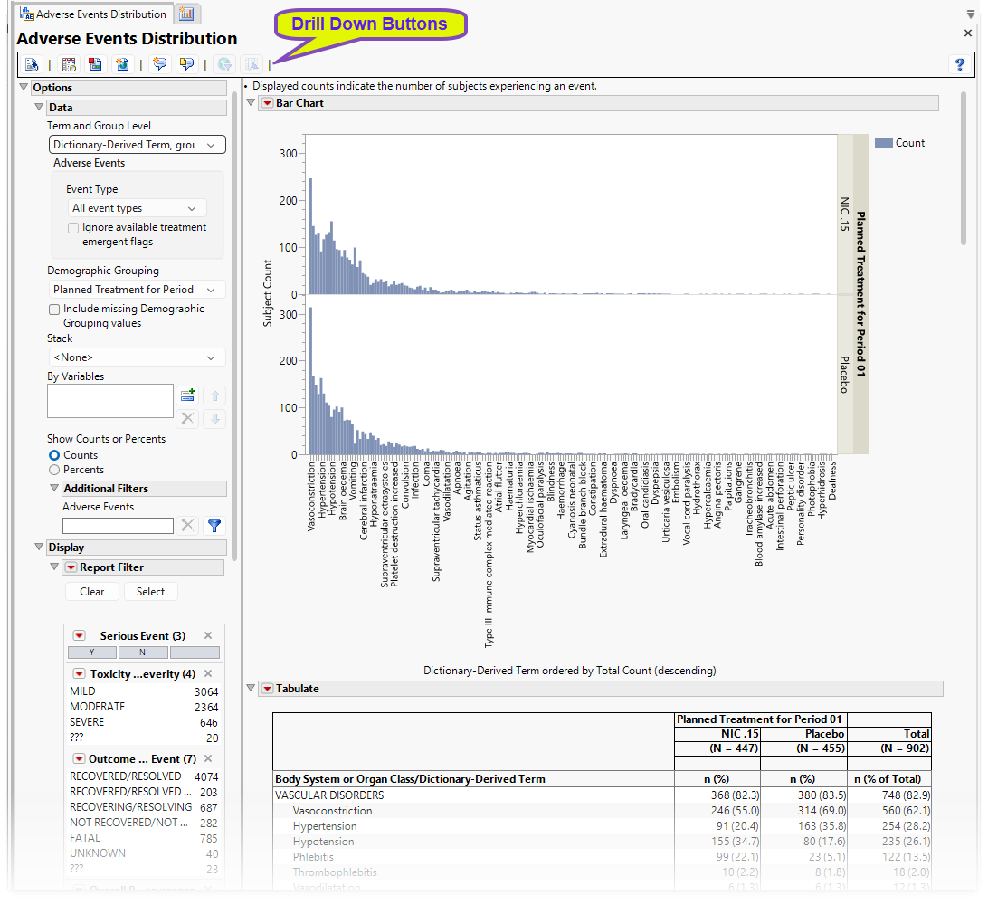

Report Results Description
Running Adverse Events Distribution with Nicardipine generates the Report for Adverse Events Distribution as shown below. In this example, Dictionary-Derived Term, grouped by Body System and Organ Class has been selected for the Term and Group level. All results shown below were generated with this selection.
The report contains the following elements:
Bar Chart
The Bar Chart summarizes the distributions of adverse events based on the term and group level selected in the drop down. Results can be displayed by treatment group or demographic grouping as well as stacked within these groups according to another criterion, such as severity/intensity of the event. By variables can be selected to display results by subgroups. Results can be displayed as counts or as percentages.
In the example shown here, Dictionary-Derived Term counts by treatment are displayed.

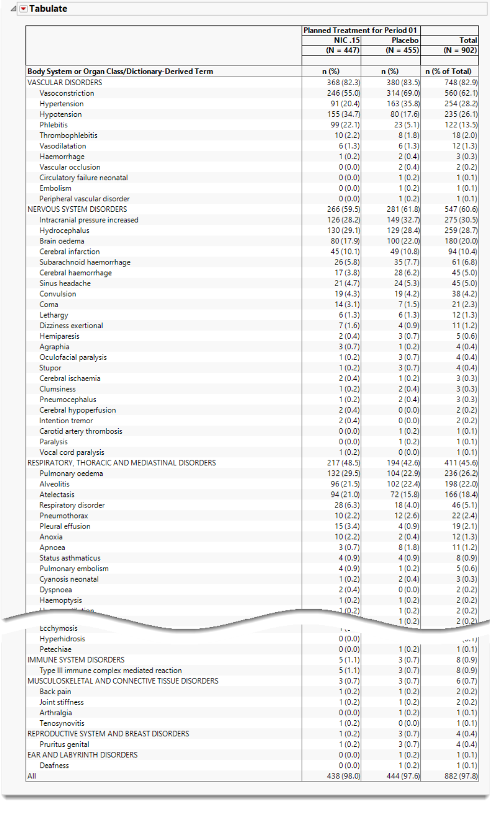

Tabulate
The Tabulate section contains one Table detailing the counts (and Percentages) for each treatment group, for each dictionary-derived term within each body system or organ class. The counts, represented by n, are the number of subjects who experienced the given adverse event. The All row at the bottom of the table is the number of subjects who experienced at least one adverse event.

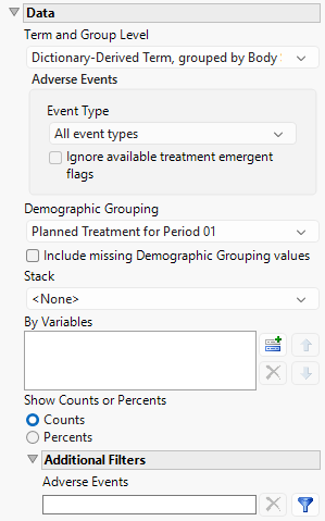

Options
Data
Use the drop-downs on this panel to customize your analysis.
Term and Group Level
Term and Group Levels are determined by the coding dictionary for the Event or Intervention domain of interest, typically these levels follow the MedDRA dictionary. Use this widget to indicate how each adverse event is named and the level at which the event is considered. For example, selecting Reported Term for the Adverse Event, grouped by Body System or Organ Class as the Term and Group Level reports the event specified by the actual event term as reported in the AE domain on the affected organ or body system.
The term level will determine which term is displayed on the x-axis of the bar chart. Both the term and group level will be shown in the table with term level nested within group level.
Event Type
Analysis can consider all events or only those that emerge at specific times before, during, or after the trial period. For example, selecting On treatment events as the Event Type includes only those events that occur on or after the first dose of study drug and at or before the last dose of drug (+ the offset for end of dosing).
Note: For information about how treatment emergent adverse events (TEAEs) are defined in JMP Clinical, please refer to How does JMP Clinical determine whether an Event Is a Treatment Emergent Adverse Event?.
Ignore available treatment emergent flags
If you choose to ignore available treatment emergent flags, the analysis includes all adverse events that occur on or after day 1 of the study when the event type is Treatment emergent events.
Demographic Grouping and Stacked
Results can be viewed as a whole or they can either be split out by Demographic Grouping or Stacked to show different levels within each event. Demographic Grouping will change the variable displayed on the y-axis of the bar chart, as well as change the variable used across the top of the table to split the columns. Stack impacts the bar chart by stacking the bars according to the levels of the chosen variable with corresponding effects in the table. For example, if severity is chosen, the bars will be stacked by mild, moderate, and severe events.
By Variables
You can subdivide the subjects and run analyses for distinct groups by specifying one or more By Variables.
Snapshot Records to Include
Use this widget to specify which updated snapshot records to include in your analysis. This option is surfaced only in studies where the number of snapshots is greater than 0.
The default state of this option is to show new, modified and stable - effectively all - snapshot records. To see specific records you must remove undesired records from the analysis. For example, to surface only the new records, select both Modified and Stable and click
. Click
to restore deleted records.
Note: JMP Clinical now relies on the JMP Compare Data Tables platform to detect new records. When duplicate rows appear, the platform evaluates them based on their row order. As a result, records are no longer labeled as Non‑Unique or Previously Non‑Unique, and the corresponding options to include those records have been removed.
Show Counts or Percents
Use this option to display results as count data or percentages.
