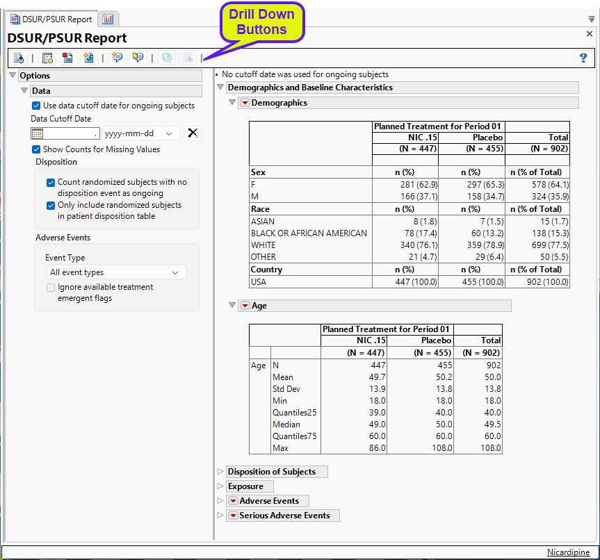

DSUR/PSUR Report
The DSUR/PSUR Report is used to generate a report for updating regulatory agencies regarding the safety of a clinical trial design and execution for the purpose of securing permission for the continuance of the trial.
Report Results Description
Running DSUR/PSUR Report for the Nicardipine study using default settings, generates the Report shown below.
The Report contains the following elements:

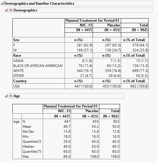

Demographics and Baseline Characteristics
The tables in this section (shown below) summarize demographic information about the subjects in this study. The first table summarizes character data; both count and percent data are provided by treatment arm. The second table summarizes numeric data.

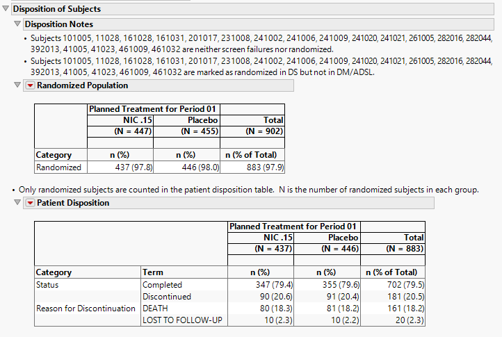

Disposition of Subjects
The notes and tables in this section (shown below) summarize disposition information about the subjects in this study. Both count and percent data are provided for each disposition event broken out by treatment arm.
For this section to be populated, the study must include either a DS or ADDS domain. In addition, DSDECOD (Standardized Disposition Term), DSCAT (Category for Disposition Event), and a start date of disposition event variable (ASTDTM, ASTDT, or DSSTDTC) must be present in the dataset.
The order of variables selected to use for Randomization of the disposition table order is as follows: first RANDFL, then RAND, then RANDOMIZED, then either RANDOM, or RANDDT in ADSL or DM. If none of those variables exist, look in DS for records where DSDECOD=RANDOMIZED.
Disposition Notes
The following notes describing disposition details may be included in this section.
| • | Subjects that are both screen failures and randomized are listed in the first note. |
| • | Subjects that are neither screen failures nor randomized are listed in the second note. However, if there is no randomization information in the data, this note states there is no randomization information. |
| • | Subjects that are marked as randomized in DM/ADSL but not in DS are listed in a third note. If randomization information only exists in DM/ADSL and not DS, then this note will state that randomization information is only in DM/ADSL. |
| • | Subjects that are marked as randomized in DS but not in DM/ADSL are listed in a fourth note. If randomization information only exists in DS and not in DM/ADSL, then this note will state that randomization information is only in DS. |

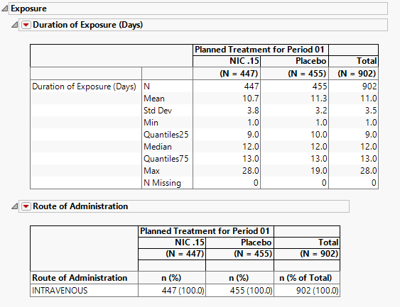

Exposure
The tables in this section (shown below) summarize length of exposure by treatment arm. Treatment administration methods are also summarized.
For this section to be populated, the study must include either a EX or ADEX domain. In addition, EXTRT (Name of Treatment), EXDOSE (Dose), and a study day of start of treatment variable (ASTDY or EXSTDY) must be present in the dataset.

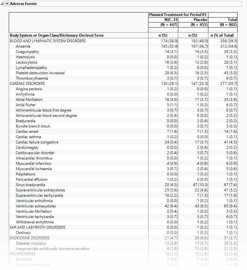

Adverse Events
The tables in this section (shown below) summarize adverse events experienced by subjects in this study. Both count and percent data are provided by treatment arm.

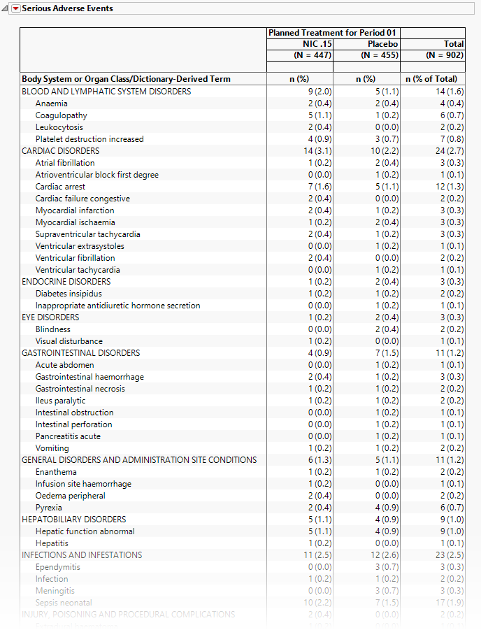

Serious Adverse Events
The tables in this section (shown below) summarize serious adverse events experienced by subjects in this study. Both count and percent data are provided by treatment arm.

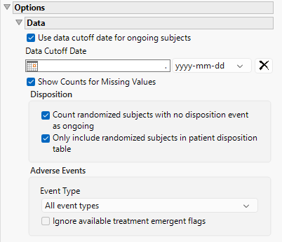

Options
Data
Use data cutoff date for ongoing subjects
For subjects who are ongoing in the study, it is useful for indicating the date on which the data for this update report was pulled, particularly when considering exposure data. The Use data cutoff date for ongoing subjects and Data Cutoff Date widgets enable you to specify and use a data cutoff date for reporting on ongoing subjects.
Check this box to use the date on which the study data was pulled for this report in place of exposure end date for ongoing subjects.
Data Cutoff Date
Use this widget to specify the date on which the study data was pulled for this report.
Show Counts for Missing Values
Checking the Show Counts for Missing Values widget adds a row to the summary statistic tables to report the number of missing records.
Count randomized subjects with no disposition event as ongoing
Check this box to count subjects who do not have a record in DS for either Completed or Discontinued as Ongoing for treatment and study status. Refer to Count randomized subjects with no disposition events as ongoing for more information.
Only include randomized subjects in patient disposition table
Check this option to include only randomized subjects in the disposition table.
Event Type
Analysis can consider all events or only those that emerge at specific times before, during, or after the trial period. For example, selecting On treatment events as the Event Type includes only those events that occur on or after the first dose of study drug and at or before the last dose of drug (+ the offset for end of dosing).
Ignore available treatment emergent flags
If you choose to ignore available treatment emergent flags, the analysis includes all adverse events that occur on or after day 1 of the study when the event type is Treatment emergent events.
| • | Click to rerun the report using default settings. |
| • | Click to view the associated data tables. Refer to Show Tables for more information. |
| • | Click to generate a standardized PDF- or RTF-formatted report containing the plots and charts of selected sections. |
| • | Select one or more subjects, then click to apply the Review Subject Filter and filter all reports in the review builder on the selected subjects. |
| • | Select a group of subjects and click to specify Derived Population Flags that enable you to distinguish the selected group of subjects from the general population. |
