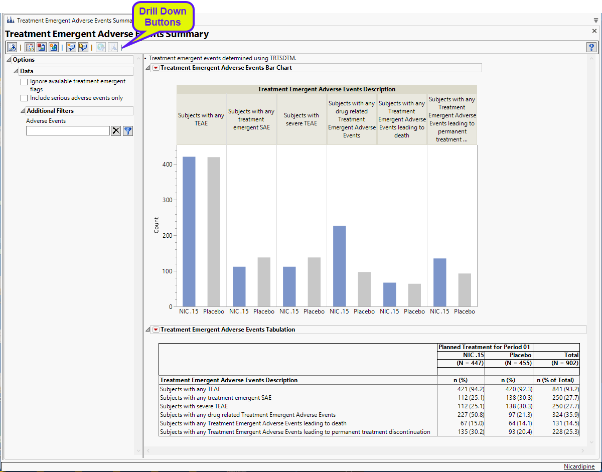

Running Treatment Emergent Adverse Events Summary for Nicardipine using default settings generates the Report shown below.
The following sections are generated by this report:
Bar Chart: This section contains a Bar Chart summarizing the counts of various treatment emergent adverse events by treatment.
Summary Table: This section contains a table that summarizes the treatment emergent adverse events. Percentages of subjects experiencing an event by arm are also included in this summary.
