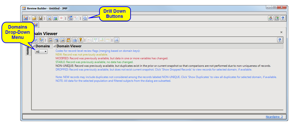

This report aids in the review of study domains for a selected set of subjects meeting specified population, WHERE statement, and Data Filter criteria. It merges the relevant data sets based on their review flag values.

Domains
This list contains special, findings, events, and interventions domains, including split domains, that are available for the current study. Many drill-down actions are applied to the currently selected domain.
Domain Viewer

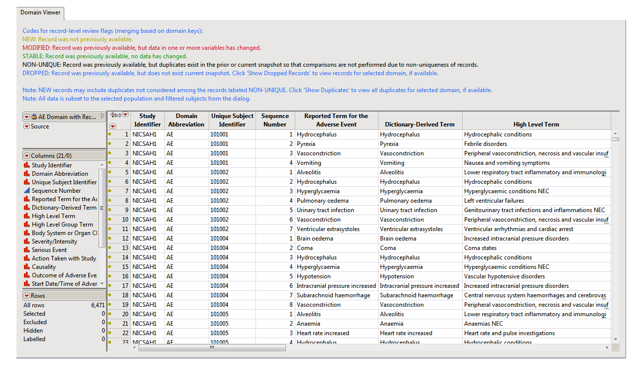

This section summarizes the definitions associated with records involved with the comparisons between snapshots for the specified domain. If this is the first time the study has been added, all records are shown as New.
It contains the following elements:
| • | One Legend. |
The legend associates color coding with record status. In the example shown above, new, modified, stable, non-unique, and dropped records are indicated with yellow, red, green, black, and blue coloring, respectively.
| • | One Table |
The domain data table is shown embedded in the dashboard.
Action Buttons
Action buttons, provide you with an easy way to drill down into your data. The following action buttons are generated by this report and are based on the currently selected Domain:

| • | View Domain: Click to open a data table for the currently selected Domain and generate colored row markers based on the legend provided on the Domain Viewer tab. The symbol varies depending on whether the record (row) has a note associated with it (asterisk) or not (filled circle). |
| • | Remove Stable Records: Click to remove any records that have remained static from before the current update. |
| • | View Domain Notes: Click to open a data table of all available notes for the currently selected Domain. This includes JMP Clinical generated notes and any record-level notes created by the user using . |
| • | Show Dropped Records: Click to open a data table of any records for the currently selected Domain that were available in the previous snapshot but are not available in the current snapshot. |
| • | Show Duplicates: Click to open a data table of any records for the currently selected Domain that are considered duplicates of one another. Duplicate records have the same values for the domain keys. The keys are available from the button. Records that have a black row marker are duplicates that occur in both the previous and current snapshot. JMP Clinical does not have the ability to compare these records between snapshots. Duplicates can also include New records that do not occur in the previous snapshot. |
| • | Show Domain Keys: Click to display the keys for the currently selected Domain. The keys are a set of variables that when taken together, uniquely identify each row of the selected domain. The keys should include variables that are not likely to change values from one snapshot to another. |

The output of this report includes data tables with records color-coded by record-level review flags.

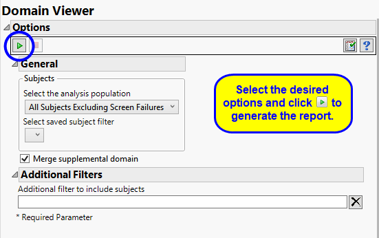

Report Options
Filtering the Data:
Filters enable you to restrict the analysis to a specific subset of subjects. You can also filter based on population flags (Safety is selected by default) within the study data.
If there is a supplemental domain (SUPPXX) associated with your study, you can opt to merge the non-standard data contained therein into your data.
See Select the analysis population, Select saved subject filter, Merge supplemental domain, and Additional Filter to Include Subjects for more information.
