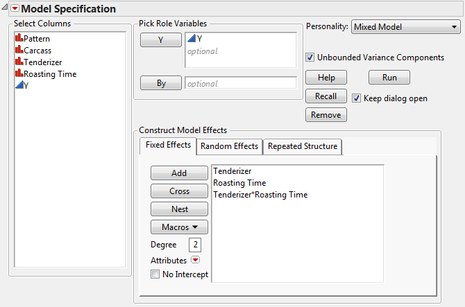

Add all fixed effects on the Fixed Effects tab. Use the Add, Cross, Nest, Macros, and Attributes options as needed. For more information about these options, see the Model Specification topic.
The fixed effects for analysis of the Split Plot.jmp sample data table appear in Fit Model Launch Window Showing Completed Fixed Effects. Note that it is possible to have no fixed effects in the model.For an example, see Spatial Example: Uniformity Trial.

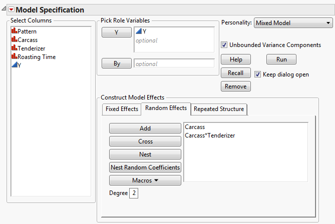

For a traditional variance component model, specify terms such as random blocks, whole plot error terms, and subplot error terms using the Add, Cross, or Nest options. For more information about these options, see the Model Specification topic.
Fit Model Launch Window Showing Completed Random Effects Tab shows the random effects specification for the Split Plot.jmp sample data where Carcass is a random block. Split Plot Example describes the example in detail.

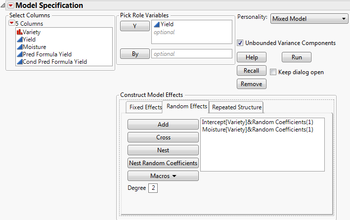

Click the Nest Random Coefficients button.
This last step creates random intercept and random slope effects that are correlated within the levels of the random effect. The subject is nested within the other effects due to the variability among subjects. If you believed that the intercept might be fixed for all groups, you would select Intercept[<group>]&Random Coefficients(1) and then click Remove.
Random coefficients are modeled using an unstructured covariance structure. Completed Fit Model Launch Window Showing Random Coefficients shows the random coefficients specification for the Wheat.jmp sample data. (See also Example Using Mixed Model.)

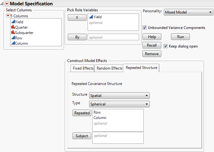

When you select one of the spatial covariance structures, a Type list appears from which you select a type of spatial structure. Four Types are available: Power, Exponential, Gaussian, and Spherical. Completed Fit Model Launch Window Showing Repeated Structure Tab shows the Spatial Spherical selection for the Uniformity Trial.jmp sample data.
