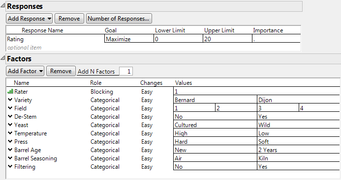

Figure 4.2 shows the completed Responses outline.
Note that Role is set to Blocking. Note also that only one setting for Values appears. This is because the number of blocks cannot be determined until the desired number of runs is specified. Once you specify the Number of Runs in the Design Generation outline, the number of levels for Rater updates to what is required.

Yeast (Cultured and Wild)
Temperature (High and Low)
Press (Hard and Soft)
Barrel Age (New and Two Years)
Barrel Seasoning (Air and Kiln)
Filtering (No and Yes)
Figure 4.2 Completed Responses and Factors Outlines

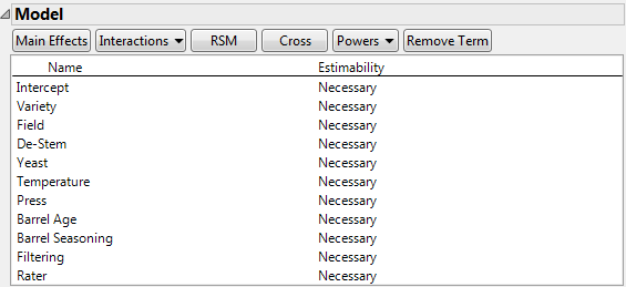

The Model outline shows all main effects as Necessary, indicating that the design needs to be capable of estimating all main effects. For this example, your assumed model reflects your interest in main effects only. However, if you wanted to estimate other effects, you could add them to the Model outline. See Model.
Figure 4.3 Model Outline

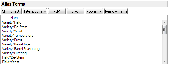

The Alias Terms outline specifies the effects to be shown in the Alias Matrix, which appears later. See Alias Matrix. The Alias Matrix shows the aliasing relationships between the Model terms and the effects listed in the Alias Terms outline. Open the Alias Terms outline node to verify that all two-factor interactions are listed.
Figure 4.4 Partial View of the Alias Terms Outline

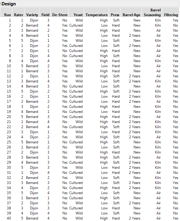

Figure 4.5 Design for Wine Experiment

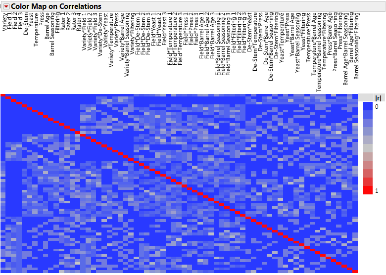

The Color Map on Correlations shows the absolute value of the correlation between any two effects that appear in either the Model or the Alias Terms outline. (The colors shown in Figure 4.6 are the JMP default colors.)
Figure 4.6 Color Map on Correlations
The only red in Figure 4.6 is on the main diagonal. The color indicates absolute correlations of one, reflecting that each term is perfectly correlated with itself. It follows that no main effect is completely confounded with any two-way interaction. In fact, the absolute values of the correlations of main effects with two-way interactions are fairly low. This means that estimates of main effects might be only slightly biased by the presence of active two-way interactions.

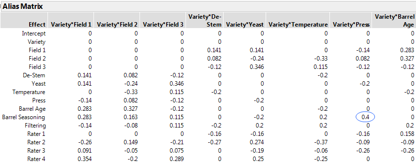

Figure 4.7 Partial View of Alias Matrix
For example, consider the model effect Barrel Seasoning. If Variety*Press is active, then the expected value of the estimate for the Barrel Seasoning effect differs from an unbiased estimate of that effect. The amount by which it differs is equal to 0.4 times the effect of Variety*Press. Therefore, what appears to be a significant Barrel Seasoning estimated effect could in reality be a significant Variety*Press effect.

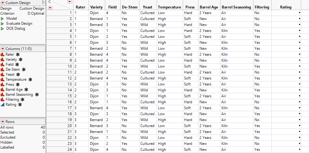

Specify the order of runs in your data table using the Output Options panel. The default selection, Randomize within Blocks, is appropriate for this example. Simply click Make Table.
Note: Your table might look different because the algorithm that creates it uses a random starting design. To obtain the precise table shown in Figure 4.9, follow the steps in Duplicate Results (Optional).
Figure 4.9 Custom Design Table
