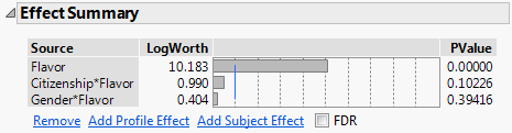

The Effect Summary report appears if your model contains more than one effect. It lists the effects estimated by the model and gives a plot of the LogWorth (or FDR LogWorth) values for these effects. The report also provides controls that enable you to add or remove effects from the model. The model fit report updates automatically based on the changes made in the Effects Summary report. See Effect Summary Report in Fitting Linear Models.
The Effect Summary report does not appear when Bayesian Subject Effects is checked in the launch window. This is because likelihood ratio tests are not conducted in this case.
Figure 5.13 shows the Effect Summary report obtained by running the script MaxDiff for Flavor in Potato Chip Responses.jmp.
Figure 5.13 Effect Summary ReportĀ

The Effect Summary table contains the following columns:
Source
Lists the model effects, sorted by ascending p-values.
LogWorth
Shows the LogWorth for each model effect, defined as -log10(p-value). This transformation adjusts p-values to provide an appropriate scale for graphing. A value that exceeds 2 is significant at the 0.01 level (because -log10(0.01) = 2).
FDR LogWorth
Shows the False Discovery Rate LogWorth for each model effect, defined as -log10(FDR PValue). This is the best statistic for plotting and assessing significance. Select the FDR check box to replace the LogWorth column with the FDR LogWorth column.
Bar Chart
Shows a bar chart of the LogWorth (or FDR LogWorth) values. The graph has dashed vertical lines at integer values and a blue reference line at 2.
PValue
Shows the p-value for each model effect. This is the p-value corresponding to the significance test displayed in the Likelihood Ratio Tests report.
FDR PValue
Shows the False Discovery Rate p-value for each model effect calculated using the Benjamini-Hochberg technique. This technique adjusts the p-values to control the false discovery rate for multiple tests. Select the FDR check box to replace the PValue column with the FDR PValue column.
