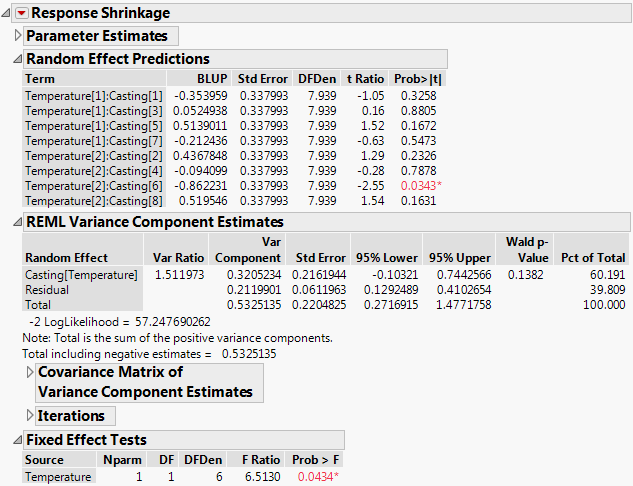

Figure 3.63 shows the report obtained for a fit to the Investment Castings.jmp sample data using the REML method. Run the script Model - REML, and then fit the model. Note that Casting is a random effect and is nested within Temperature.
Figure 3.63 Fit Least Squares Report for REML Method
Random Effect Predictions
For each term in the model, this report gives an empirical estimate of its best linear unbiased predictor (BLUP) and a test for whether the corresponding coefficient is zero.

REML Variance Component Estimates
When REML is selected as the fitting method in the Fit Model launch window, the REML Variance Component Estimates report is provided. This report contains the following columns:

Fixed Effect Tests
When REML is used, the Effect Tests report provides tests for the fixed effects. This report contains the following columns:
