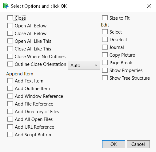

An alternative way to access these options is to hold down the Alt key and right-click the disclosure icon . This displays a window, as shown in Figure 9.3, with check boxes for commands and options so that you can select multiple actions at the same time. You can also do the same for the menu under a red triangle menu.
Figure 9.3 Outline Box Menu Items Window
