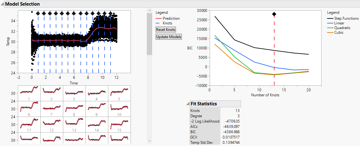

Figure 15.1 B-Spline Model Selection in FDE
