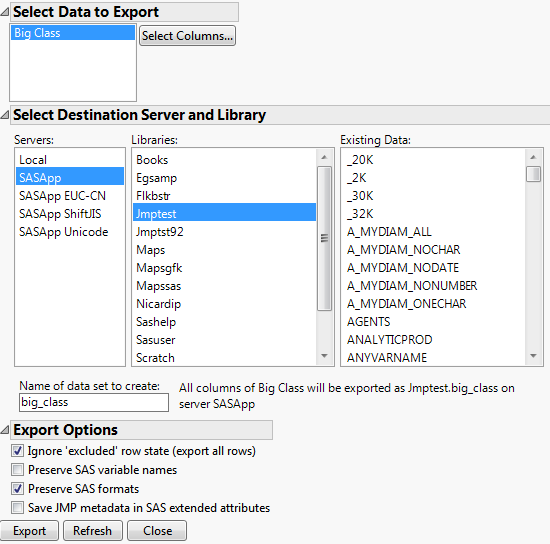

Export JMP Data Tables to SAS
You can export JMP data tables to a SAS Workspace Server.
1. Connect to the SAS Workspace Server.
2. Open the file that you want to export.
3. Select File > SAS > Export Data to SAS.
If necessary, you are connected automatically using your profile’s user name and password.
4. Select the data table that you want to export to SAS from the list of open data tables under Select Data to Export.
Figure 3.65 Export Data to SAS
Export Data to SAS
5. (Optional) To export only some of the columns in the data table, click Select Columns. See To select columns to export.
6. Select the Destination Server.
7. Select the Library.
Tip: If your libraries do not appear, see Show Libraries in the Export Data to SAS Window.
A list of the data sets in the library appears.
8. Enter the name as you want it to appear in the SAS library.
9. (Optional) Set the export options that you want to use. See Export Options.
10. Click Export.

Export Options
Ignore ‘excluded’ row state (export all rows)
Select this option to export all rows in the data table. Deselect this option to export only those rows that are not excluded. This option is on by default.
Preserve SAS variable names
This option is useful for data tables that were imported originally from SAS. When importing a SAS data set, the original SAS variable name is saved in a column property for each column. Select this option to use the SAS variable name for each column when exporting to SAS. Deselect this option to export the JMP variable names. This option is off by default.
Preserve SAS formats
This option is useful for data tables that were imported originally from SAS. When importing a SAS data set, the original SAS format and informat is saved in a column property for each column. Select this option to use the SAS format and informat for each column when exporting to SAS. Deselect this option to export the JMP formats instead. This option is on by default.
