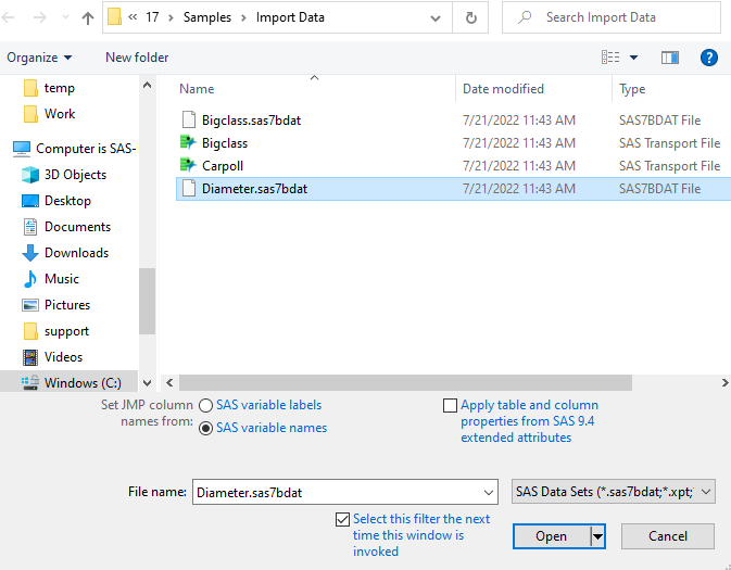

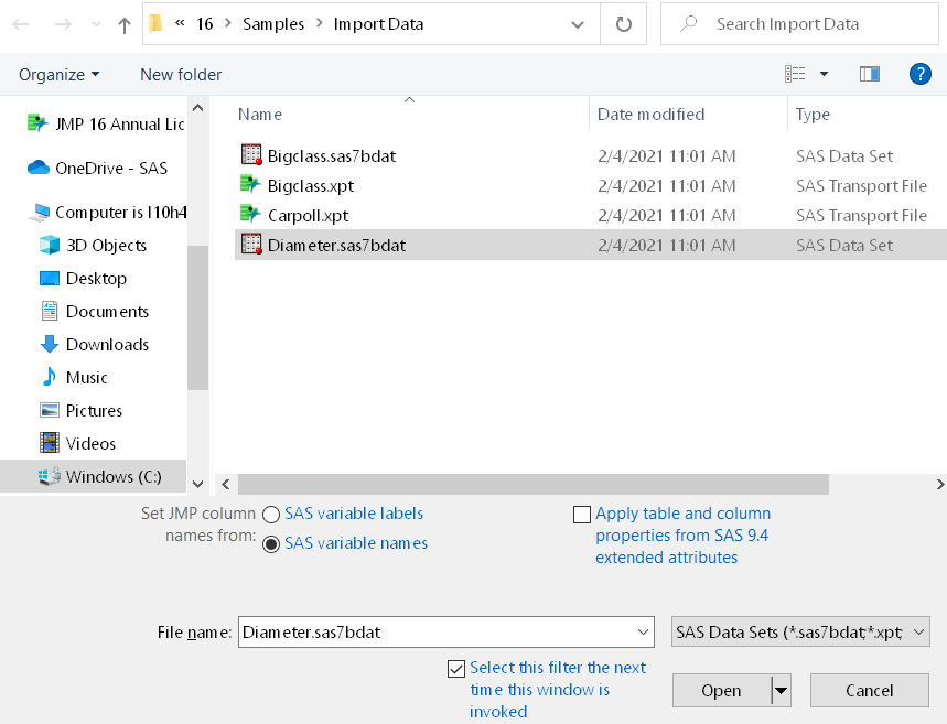

1. Select File > Open.
2. (Windows only) Select SAS Data Sets from the list next to File name as shown in Figure 3.50.
Note: SAS variable names and formats are preserved and can be saved after changes are made to the SAS data set. See Save JMP Data as a SAS Data Set.
3. Select the file.
Figure 3.50 Open SAS Data Set
Open SAS Data Set
Note: To select the columns to import, click the arrow on the Open button and select Select columns.
