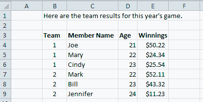

For the figures in this example, we used the Team Results.xlsx file located in the JMP Samples/Import Data folder. The file has the following characteristics:
– the data begin on row 4, column 2 and end on row 9, column 5
– two worksheets
– the second worksheet has two sets of merged cells
– no hidden rows or columns
Figure 3.2 Team Results.xlsx Worksheet

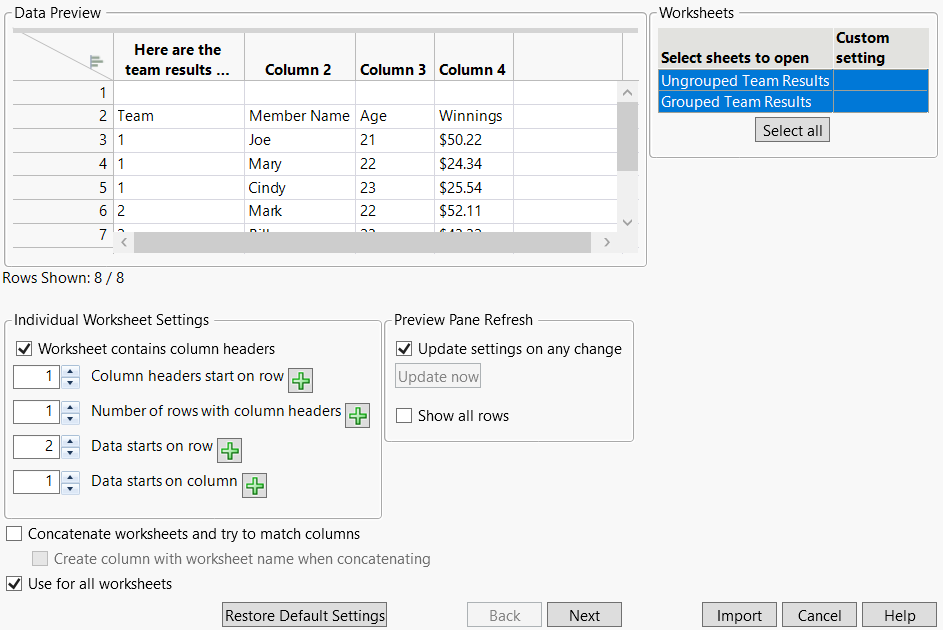

The worksheet opens in the Excel Import Wizard, where a preview of the data appears along with import options.
Figure 3.3 Example Initial Data Preview
Note the following characteristics in the Data Preview:
– Both worksheets are selected for import in the upper right corner.
– The first column has been automatically been removed.
– Text from the first row of the worksheet appears as the column headings. However, you want the text in row 3 of the worksheet to be used as the column headings.
– The first data row is empty.
Note: JMP remembers your previous changes each time you import a worksheet, even after closing and reopening JMP. This feature is helpful when you want to reimport the same worksheet several times and experiment with options. To clear those changes when you import a different worksheet, click Restore Default Settings.

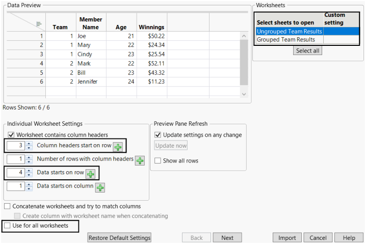

5. For Column headers start on row, type 3.
6. For Data starts on row, type 4.
7. For Number of rows with column headers, type 1.
8. Data starts on row should be set to 4.
9. Data start on columns should be set to 1.

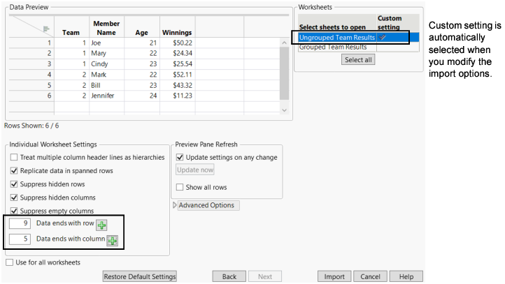

10. Select Ungrouped Team Results in the Worksheets pane.
Only this worksheet will be imported.
11. Deselect Use for all worksheets.
These settings apply only to Ungrouped Team Results.
Figure 3.4 Selecting the Column Header Row
Tip: Right-click a numeric column header in the Data Preview pane to change the format.
See Individual Worksheet Settings for more information about all options.
12. Click Next to configure other import settings.

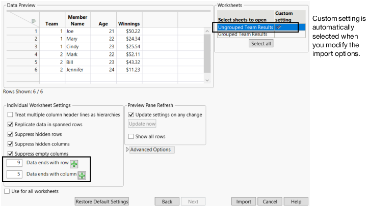

13. For Data ends with row, type 9.
14. For Data ends with column, type 5.
Figure 3.5 Specifying the Last Column
See Additional Individual Worksheet Settings for more information about all options.

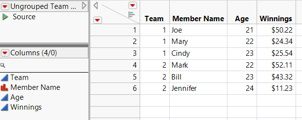

15. Click Import to convert the worksheet as you specified.
Figure 3.6 Final Data Table
Final Data Table

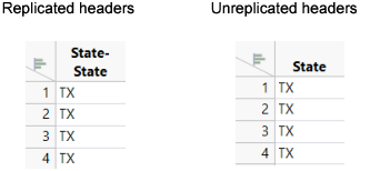

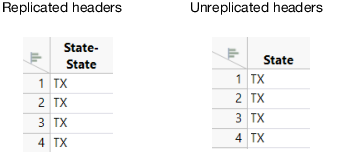

Replicate headers in spanned rows
Repeats the header text in each cell for rows that are spanned in the worksheet. For example, the State column heading shown in Figure 3.7 was in a merged cell in the worksheet. On the left, the heading is replicated. Deselect the option to avoid repeating the heading as shown on the right.
Figure 3.7 Replicated Headers in a Microsoft Excel File

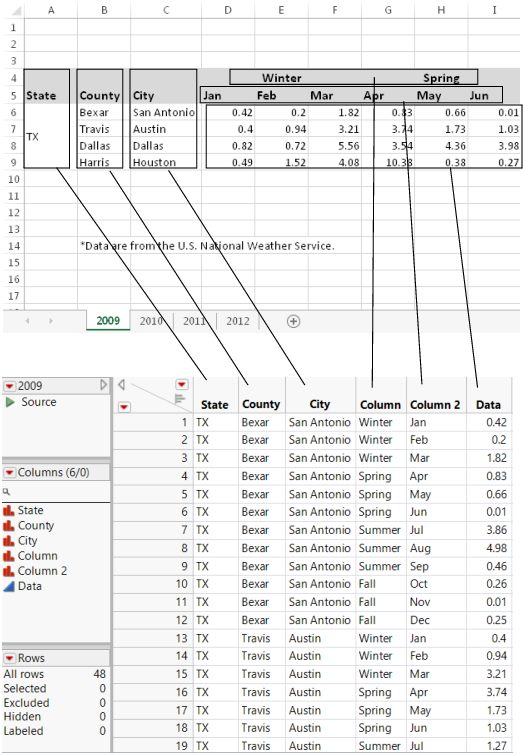

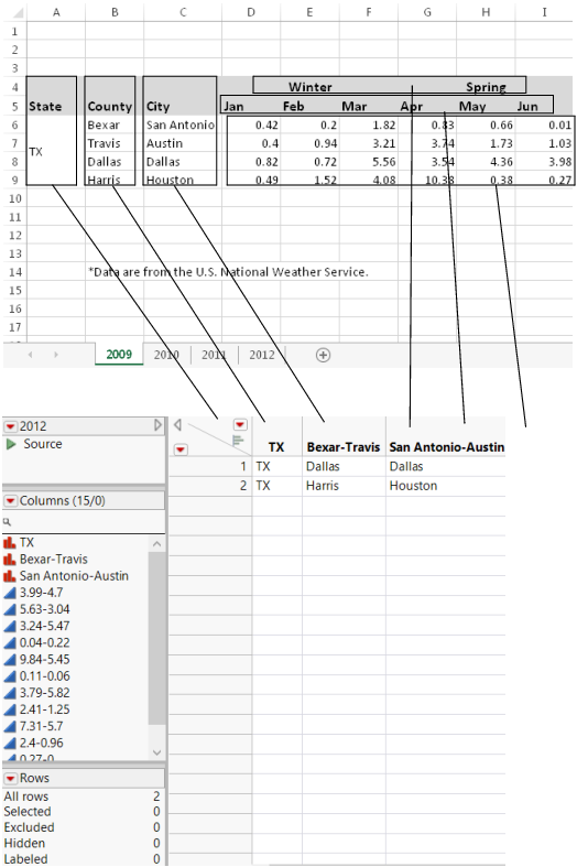

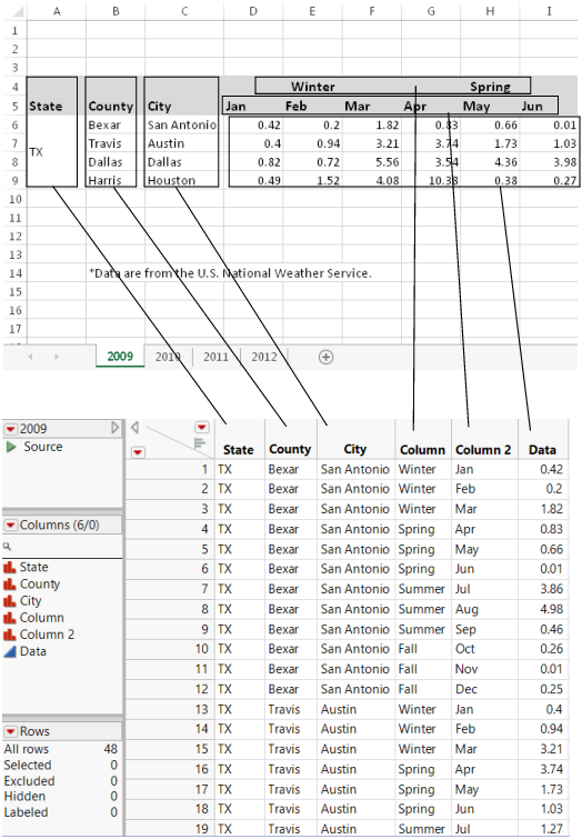

In an Excel worksheet, multiple header rows can have an implied hierarchy; the second header row contains data that are categories of the first header row. Figure 3.8 shows an example. In the worksheet at the top, the seasons “Winter” and “Spring” are in spanned cells above the months within those seasons. In the JMP data table, you want the seasons in one column and their corresponding months in another column.
Figure 3.8 The Original Data in Excel and Final Data in JMP for 2009
The Original Data in Excel and Final Data in JMP for 2012

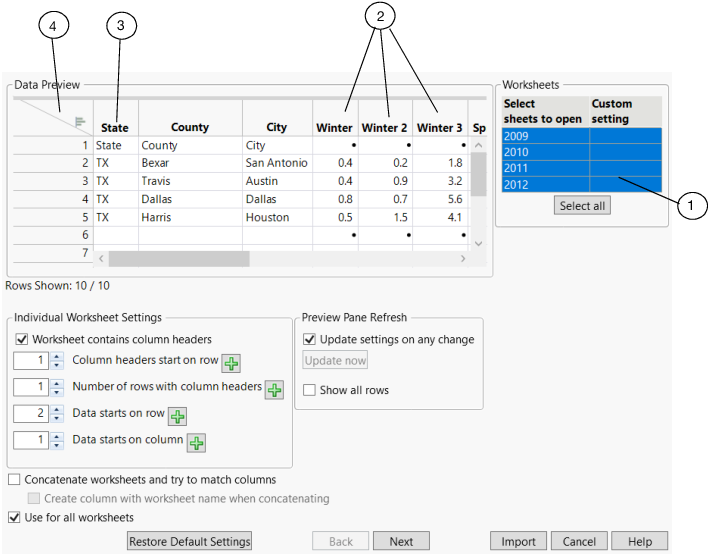

Figure 3.9 Excel Import Wizard Preview
Figure 3.9 shows the default settings for this worksheet:
1
All worksheets are selected for import. Press Ctrl and click a worksheet to exclude it from the import.
2
Each season is split over several columns.
3
Data from the second heading row of the worksheet appear in the first row.
4
The empty rows at the top have been removed.

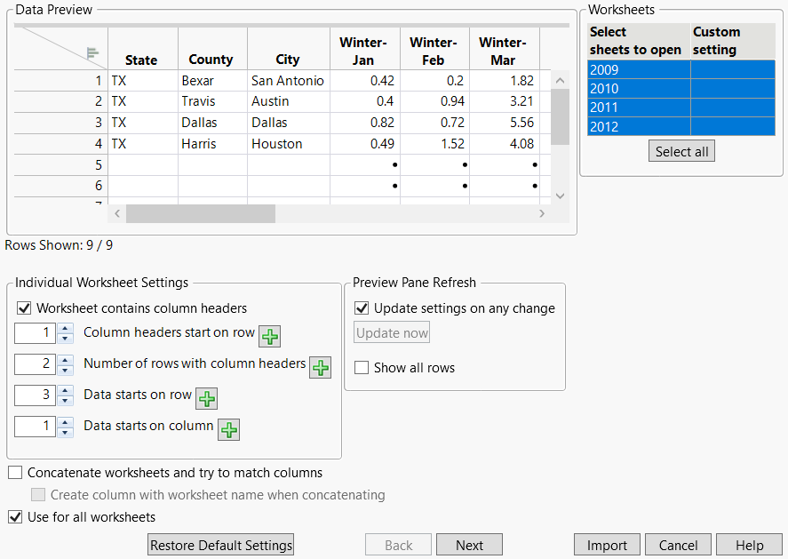

4. Next to Number of rows with column headers, click the up arrow once.
Notice that Data starts on row automatically updates to 3.
Figure 3.10 Updated Settings on Page One

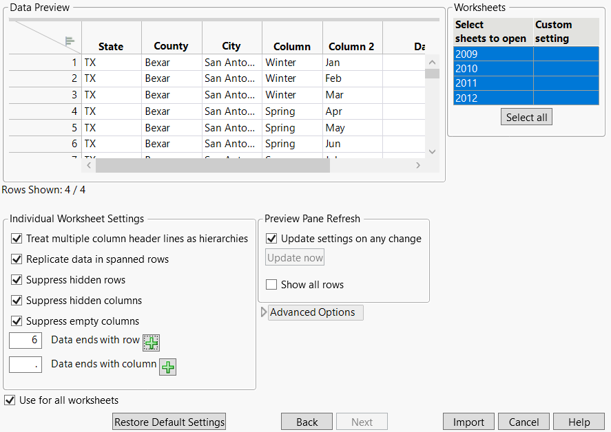

6. Next to Data ends with row, type 6 and press Enter.
After the first three empty rows are removed from the worksheet, the data end with row 6.
Tip: Instead of you typing the end row number, JMP can calculate the row for you. In the Data Preview pane, select row 4. Click the plus sign Image shown here next to Data ends with row.
Figure 3.11 Updated Settings on Page Two
Notice that Replicate data in spanned rows is selected by default. JMP unmerges data that were merged in the worksheet and copies the cell contents as separate categories. “TX” was originally in a merged cell. In JMP, it will be copied into separate cells.
7. Select Treat multiple column header lines as hierarchies.

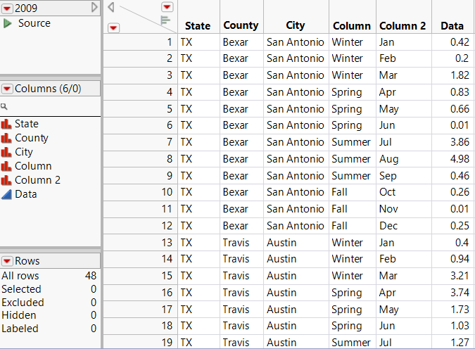

Each season and month in the header rows of the worksheet will become categories in the data table.
8. Click Import.
The four worksheets open as separate data tables. The data tables contain a Source script, which you can run to import the data into new data tables using the same import settings (Figure 3.12). Your import settings are also saved the next time you open the worksheet in the Excel Wizard in any JMP session.
Figure 3.12 The Final Data
The Final Data
