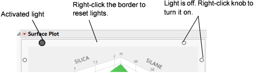

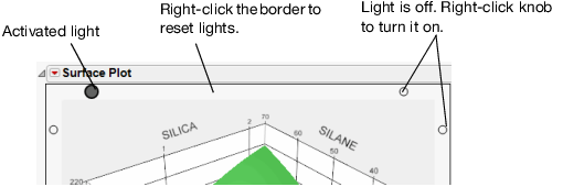

Lights
By default, the plot has lights shining on it. There are eight control knobs on the plot for changing the position and color of the lights. This is useful for highlighting different parts of a plot and creating contrast. Four of the eight knobs are shown in Figure 5.7.
You can perform the following actions to adjust the lights shining on the surface:
– Right-click a knob to turn that light on or off. More lights turned on brighten a plot, and fewer lights darken it.
– Drag a knob to change the position of a light.
– Change the color of a light by right-clicking on the knob. The default color is white.
Figure 5.7 Control Knobs for Lights
