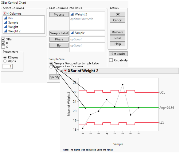

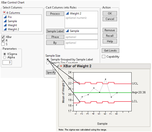

The illustration in Figure 14.4 shows an XBar chart for a process with unequal subgroup sample sizes, using the Coating.jmp sample data from the Quality Control sample data folder.
Figure 14.4 Variables Charts with Unequal Subgroup Sample Sizes
