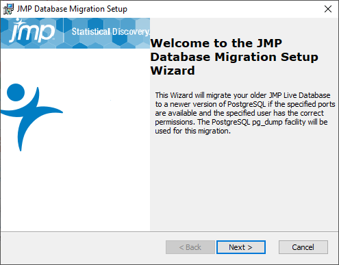

Figure 1.10 JMP Live Database Migration Setup Wizard
7.
Click Next.

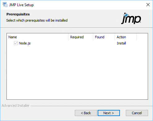

Figure 1.29 Select Prerequisites to Install
Node.js is selected by default and must be installed.
6.
Click Next.

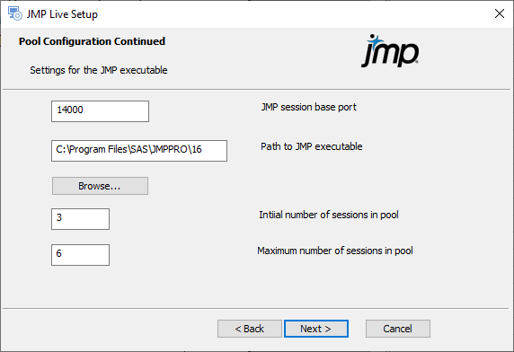

JMP needs to be installed using its own installer on all machines that support creating JMP sessions, whether that is part of the JMP Pool Manager or the worker pool. These sessions of JMP will be started to do work for JMP Live when reports are modified.
18.
Specify these JMP details:
JMP session base port: Enter the base port used by the JMP sessions to talk with the JMP Pool Manager. Each instance of JMP has a unique number starting with this base number.
Path to JMP executable: Enter the path to the JMP Pro location. The default installation path appears, so you need to change this only if JMP Pro is located elsewhere.
Initial number of sessions in pool: Enter the number of JMP sessions that will be started when the pool is first run.
Maximum number of sessions in pool: Enter the upper limit for the number of JMP sessions that are allowed to run on this machine as part of this pool. These sessions are added if the number specified in the initial number of sessions are all in use.

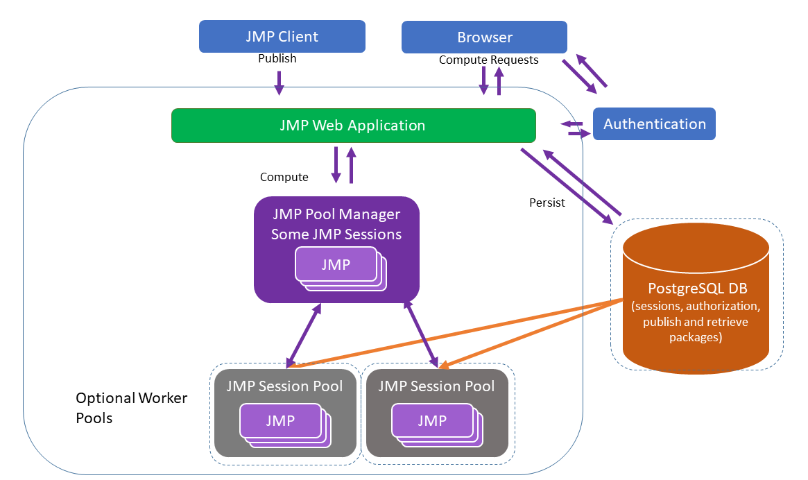

About JMP Live Architecture and Authentication
If you are installing the JMP Live server on-premises, you should understand the architecture of the JMP Live system and possible configurations for authentication with third-party identity providers.
Architecture Overview
JMP Live consists of several modules communicating with each other. This architecture makes it possible to distribute the workload across different computing resources to handle larger request loads.
Figure 1.43 JMP Live Architecture
You can run JMP Live on a single computing resource, but this setup is not recommended. The recommended setup is to keep the database separate from the other components of JMP Live, and to give the database a dedicated computing instance that is frequently backed up to ensure the safety of the JMP Live content. The database can be on a hosted service, and the rest of the components can be hosted in on-premises resources. In that scenario, you would not use the JMP Live Database Installer, but would need to set up a PostgreSQL 13 compatible instance on the hosted service. Follow the instructions in Install JMP Live Using an Existing Database.

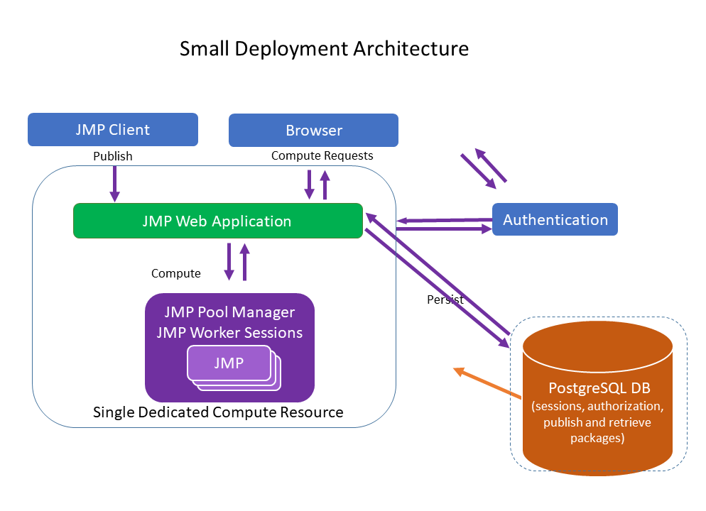

Small Deployment
In a small JMP Live deployment (such as 100 users), it is possible to install everything except the database on a single dedicated machine.
Figure 1.44 Recommended Configuration for a Small Deployment
In this scenario, the JMP web and the JMP Pool components are installed on the same machine. During the installation, select the option to Configure as Pool Manager. The number of JMP instances associated with this JMP Pool Manager are the total number of JMP instances that are run for the site.
For the capabilities of this computing resource, more is always better, and much depends on the processor type, network speeds, and so on. An absolute minimum to consider is a 4-core machine with at least 16 gigabytes of dedicated RAM. The amount of storage is most important for the database and depends on the number of reports stored. One terabyte of storage is the minimum.

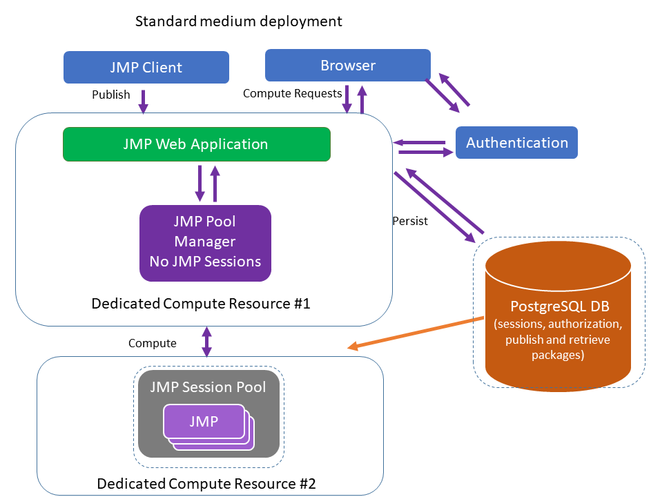

Medium Deployment
In a medium JMP Live deployment (such as 500 users), there are two configurations that you can consider, based on the type of reports that are being retrieved:
If you have a high number of report retrievals, but the reports themselves do not contain data filters or the need to recompute the statistics, then the primary area of concern is the JMP web component.
If there are a lot of report computations required, then the primary area of concern is the JMP Pool Manager.
In cases where the JMP web component is of primary importance, or if you do not know whether you will have a compute-intensive environment, the recommended configuration is below.
Figure 1.45 Recommended Configuration for a Medium Deployment
In a standard configuration where the JMP web component needs optimum performance, the JMP Pool Manager does not have JMP sessions of its own. You set the number of JMP sessions in the JMP Pool Manager to zero. All JMP sessions reside on the second computing resource, the JMP Session Pool.
If you need a more compute-intensive environment, then assign sessions to the JMP Pool Manager (perhaps five). This might reduce the performance of the JMP web component, but provides additional computing capacity for reports.

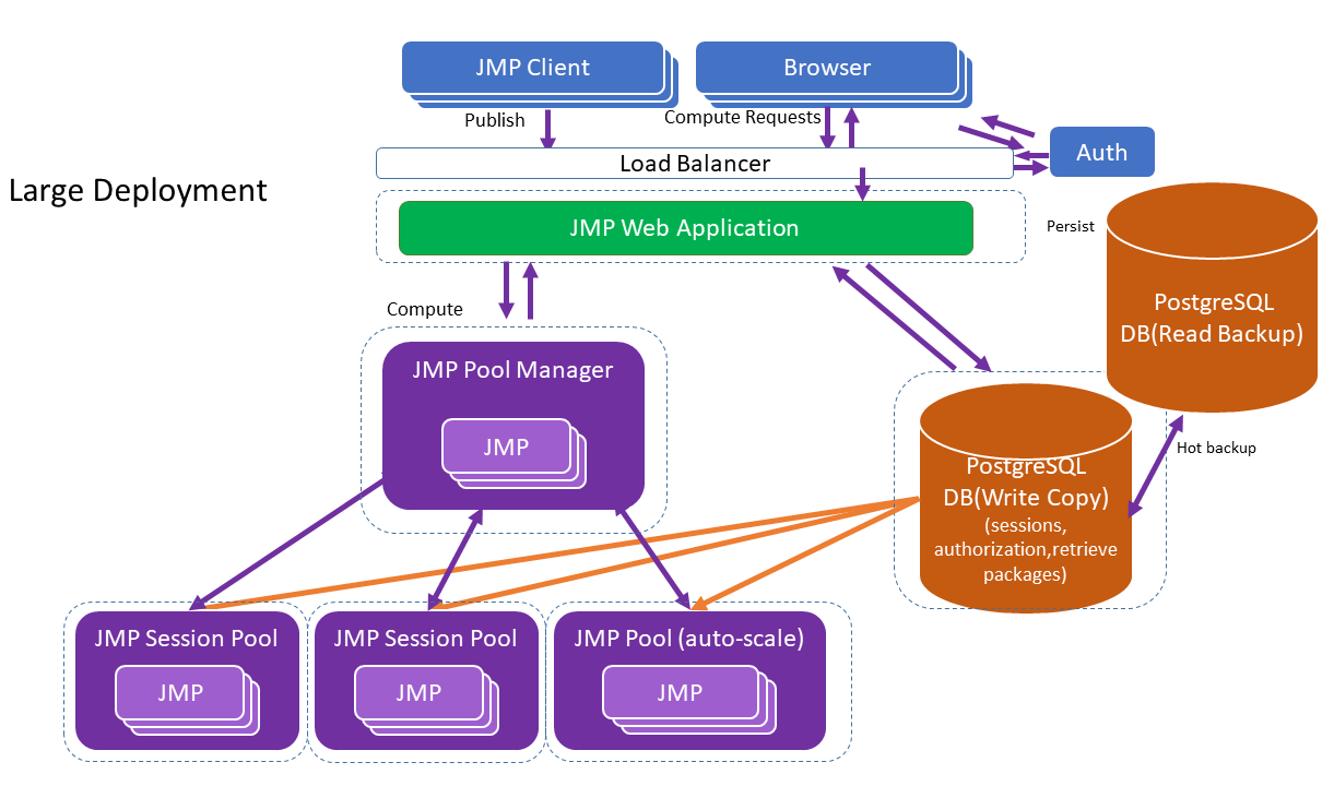

Large Deployment
In a large JMP Live deployment (such as 2,000 users), you might need multiple JMP Session Pools and a separate dedicated computing resource for the JMP Pool Manager.
Figure 1.46 Recommended Configuration for a Large Deployment
The JMP web component, JMP Pool Manager component, JMP Session Pools, and PostgreSQL databases are all dedicated instances. The number of JMP sessions that you can have depends on the computing power and memory capacity of each instance.
Here are some suggestions for each instance:
JMP web component and JMP Session Pool instances: A suggested minimum of 4-core machines, but preferably 8-core machines with 32 gigabytes of RAM.
JMP Pool Manager: A suggested minimum of a 4-core machine with 16 gigabytes of RAM.
PostgreSQL databases: The machines should anticipate the storage requirements based on the volume of publishing for your organization. A scalable instance would be best, otherwise 5 terabytes of storage is a suggested minimum.
The following elements are also suggested:
A load balancer to provide a single entry point to handle the security of HTTP and HTTPS requests.
A read backup of the PostgreSQL database to provide a quick switchover in the event of a failure or connectivity issue with the primary database. The backup should be updated frequently.
