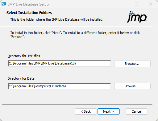

Figure 1.2 Specify Installation Folders
Specify where to install the JMP Live database and the PostgreSQL database:
Click Next to accept the default location.
Click Browse to change the default installation folder.
Note: Make sure you have adequate space in the directory where you install the PostgreSQL database.

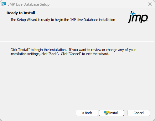

Figure 1.4 Start JMP Live Database Installation
5.
Click Install.
6.
Click Finish once the installer is done.

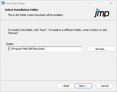

Figure 1.7 Specify the Keycloak Install Location
Specify where you want to put the Keycloak installation files, and then click Next.
Note: The Keycloak files are placed in a subfolder in the install directory. This subfolder cannot be moved or changed.

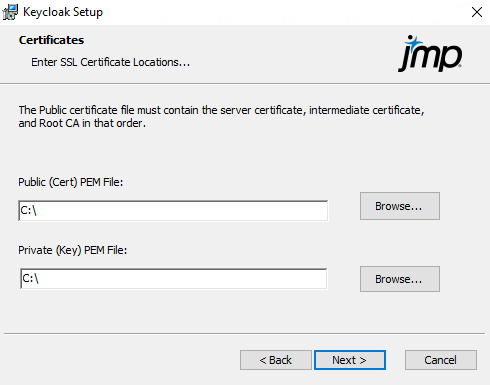

Figure 1.11 Specify Keycloak Certificates
Keycloak requires SSL certificates to guarantee your organization's authenticity and to allow secure connections between Keycloak and identity providers.
Caution: Installation fails if you do not specify these certificates.
9.
Specify the locations of your organization’s SSL certificates. These must be obtained from an authorized provider.
SSL certificates are text files containing cryptographic keys that enable a browser and the web server to have secure communication. These keys are specific to an organization and are provided by third-party vendors like DigiCert, Symantec, and Network Solutions. JMP Live cannot run without these certificates.
The Public key must point to a file that contains the certificate, intermediate certificate, and root certificate, concatenated in that order.
The Private key file is supplied by the third-party vendor that provided the Public key certificate.

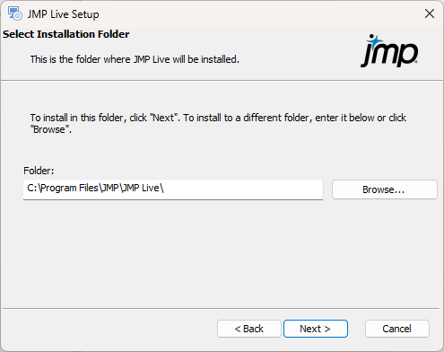

Figure 1.22 Specify Installation Folder
8.
Specify where to install JMP Live:
Click Next to accept the default location (recommended).
If you change the default location, note the following:
The changed folder contains the JMP Live installation files, but PostgreSQL is always installed in its default location.
Since JMP Live can generate log information, make sure that there is adequate disk space in the new location. 1 gigabyte is the recommended minimum.

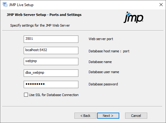

Figure 1.24 Specify Ports and Database Details
11.
Specify the following JMP web server settings:
Web server port: Enter the HTTPS port that will take requests from a browser. By default, this port is set to 3501. You can specify port 443 (the default HTTPS port), but it is recommended to use a dedicated port for easier monitoring and access control. If you install an application load balancer in front of the web server component, specify this port.
Database host name: port:
Enter the DNS name of the machine that is running the PostgreSQL database for JMP Live. The default name is localhost (the install machine), but typically this would specify a dedicated server running PostgreSQL. This machine could be within a corporate firewall, outside the firewall, or in a cloud service.
Enter the port that was specified during the installation of PostgreSQL for communication from the outside. The default PostgreSQL port is 5432. See Figure 1.3.
Database name: Enter the name assigned to the JMP Live database within PostgreSQL. It is possible to change this name, but not recommended, as the database installer defaults to webjmp.
Database user name and Database password: Enter the administrator user ID and password that you specified while installing the JMP Live Database. The Database user name should be dba_webjmp, but you likely changed the password from the default (which is Password1). Enter that password here.
Use SSL for Database Connection: Select this option if your PostgreSQL database requires SSL encrypted communications.

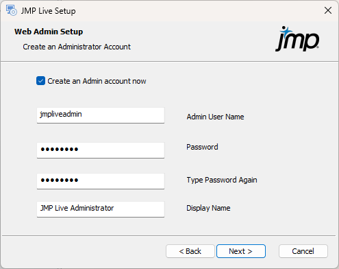

Figure 1.25 Create an Administrator Account
Note: It is strongly recommended that you create an administrator account. However, if you are updating JMP Live from a previous version and already have an administrator account in the database, then you can safely skip this step by deselecting the Create an Admin account now box.

Enter the administrator user name that you will log on to JMP Live with. Provide a password (default is password) and a display name that will appear when you post content to JMP Live. Note the following:
The Admin User Name must not contain spaces and must be lowercase.
Once you create an administrator account, you can log on to this account and designate other users as administrators.
You can create an administrator account at any time using a command line interface. See Maintain the JMP Live Database.

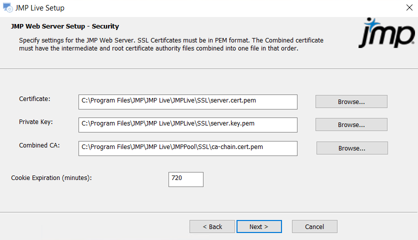

Figure 1.26 Specify SSL Certificates
13.
Navigate to or enter the SSL certificates for your organization.
The primary certificate and private key are configured for the purchaser. The Combined CA comes from a third-party vendor and is a single file that contains the intermediate and root certificate (in that order).
The JMP Live installer provides a certificate set that allows for minimal testing on a localhost setup. However, it generates warnings when the site is viewed in the local browser, and the site is inaccessible from browsers outside the install machine.
Tip: You can validate the SSL certificates after the JMP Live installation is complete. See Validate SSL Certificates for JMP Live. To run the SSL certificate validation utility, from a node.js command line, enter the following directory and command: C:\Program Files\JMP\JMP Live\JMPLive>npm run check-ssl.
14.
Cookie Expiration: Specify how long the JMP web component remembers that you signed in to JMP Live.
The default value is 720 minutes (12 hours) but you can shorten this for increased security.
Cookie Expiration is not the same as an idle time-out. You can be using the site constantly, but the cookie expiration forces you to sign in again after it expires.

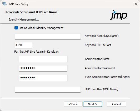

Figure 1.27 Set Up Keycloak
Note: Instead of using Keycloak, it is possible to add a direct connection to Microsoft Active Directory. See Use Active Directory or LDAP. Please be advised that this method will not be supported in future versions of JMP Live.
15.
Specify the following Keycloak settings:
Use Keycloak Identity Management: Enables the Keycloak authentication system. If you deselect this option, Local authentication is used. In this case, users need to create accounts in JMP Live. These users will not be authenticated against different identity providers. For details about connecting Keycloak to your identity provider, see the Keycloak documentation.
Keycloak Alias (DNS Name): Specify the name of the server machine that is running the Keycloak authentication service.
Keycloak HTTPS Port: Specify the number of the port that Keycloak expects to receive requests on. The default port is 8443.
Administrator Name: Specify the administrator name for the JMP Live realm in Keycloak. The realm keeps JMP Live credentials separate from any other software applications that might be using Keycloak authentication.
Administrator Password: Specify the administrator password for the JMP Live Keycloak realm.
JMP Live Alias (DNS Name): Specify the name of the machine that will be running the main JMP Live site.

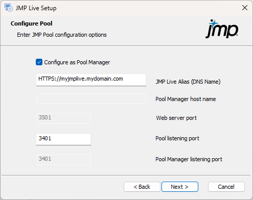

17.
Specify the Pool Manager options:
JMP Live Alias (DNS Name): Enter the DNS name, which typically looks like this: machine name.domain name.com/org. Note the following:
Unless you are installing all components using the localhost option, you need to specify the web host name.
Even if you have all components on one machine, you likely want to use your organization's SSL certificates for a secure connection. In that case, specify the machine name as the web host name, since the certificates are usually tied to the machine.
Pool Manager host name: (Disabled if you are selected Configure as Pool Manager.) If you are setting up a worker pool on a separate machine, enter the DNS name of the machine that is handling the Pool Manager duties.
Web server port: (Disabled if you are installing all components on the same machine, as the port number is already specified in the JMP web component.) If you are installing only the JMP Pool component, enter the port that you used when installing the JMP web component on another machine.
Pool listening port: Enter the port that this pool is listening on for communication from the JMP Pool Manager and JMP web components.
Pool Manager listening port: (Enabled only if you are configuring a worker pool.) Enter the port that was specified as the Pool listening port for the JMP Pool Manager setup. The worker pool needs to know this port in order to tell the JMP Pool Manager that it is available.

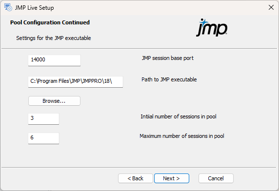

Specify these JMP details:
JMP session base port: Enter the base port used by the JMP sessions to talk with the JMP Pool Manager. Each instance of JMP has a unique number starting with this base number.
Path to JMP executable: Enter the path to the JMP Pro location. The default installation path appears, so you need to change this only if JMP Pro is located elsewhere.
Initial number of sessions in pool: Enter the number of JMP sessions that will be started when the pool is first run.
Maximum number of sessions in pool: Enter the upper limit for the number of JMP sessions that are allowed to run on this machine as part of this pool. These sessions are added if the number specified in the initial number of sessions are all in use.
Note: If you are installing the Pool Manager, and only want it to handle resource allocation to other worker pools, you can set both the initial and the maximum numbers to zero. In this case, the site will not function until worker pools are configured and running.

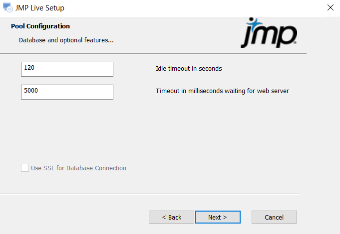

19.
Idle timeout in seconds: Enter the length of time that a JMP instance waits for additional work before dropping the connection with the JMP web component and waiting for a new request.
Timeout in milliseconds waiting for web server: Enter how long an instance waits for further communication during an existing transaction before it gives up and discards the existing work request.
SSL Combined Intermediate and Root Certificate file in PEM format: (Appears if you are installing the JMP Pool Manager component only) Specify the location of the certificate file that combines the Intermediate and Root certificates (in that order).
