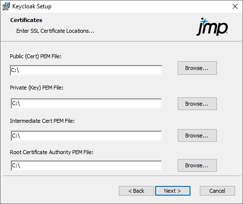

Figure 1.20 Specify Keycloak Certificates
Keycloak requires SSL certificates to guarantee your organization's authenticity and to allow secure connections between Keycloak and identity providers.
Caution: Installation fails if you do not specify these certificates.
9.
Specify the locations of your organization’s SSL certificates. These must be obtained from an authorized provider.
SSL certificates are text files containing cryptographic keys that enable a browser and the web server to have secure communication. These keys are specific to an organization and are provided by third-party vendors like DigiCert, Symantec, and Network Solutions. JMP Live cannot run without these certificates.
The primary certificate and key are configured for the purchaser. The Root (CA) certificate comes from the third-party vendor.
10.
Click Next.
