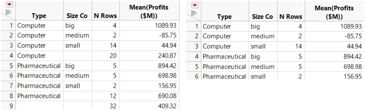

To include marginal statistics
To add marginal statistics (for the grouping variables) to the output columns, click the box beside Include marginal statistics. In addition to adding marginal statistics for each grouping variable, JMP adds rows at the end of the table that summarize each level of the first grouping variable.
1. Select Help > Sample Data Folder and open Companies.jmp.
2. Select Tables > Summary.
3. Select Profits ($M) and click Statistics.
4. Select Mean.
5. Select Type and Size Co and click Group.
6. Select Include marginal statistics.
7. Click OK.
See the left side of Figure 8.2.
Figure 8.2 Summary Table with and without Marginal Statistics
Compare the summary table with marginal statistics (on the left side in Figure 8.2) to the summary table without marginal statistics (on the right side). Notice that the marginal statistics are added, along with a row that shows that there are 32 total Computer and Pharmaceutical companies.
